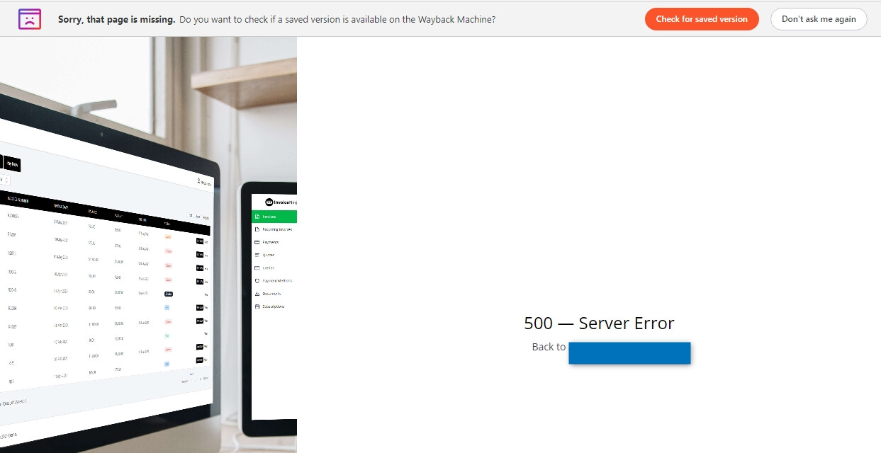

I’ve enabled debug in the .env file:
Enabling debug doesn’t unfortunately remove the default error splash screen:
and display any more information that could lead you in the right diction or at least give you some kind of lead/clue to what is going south here.
