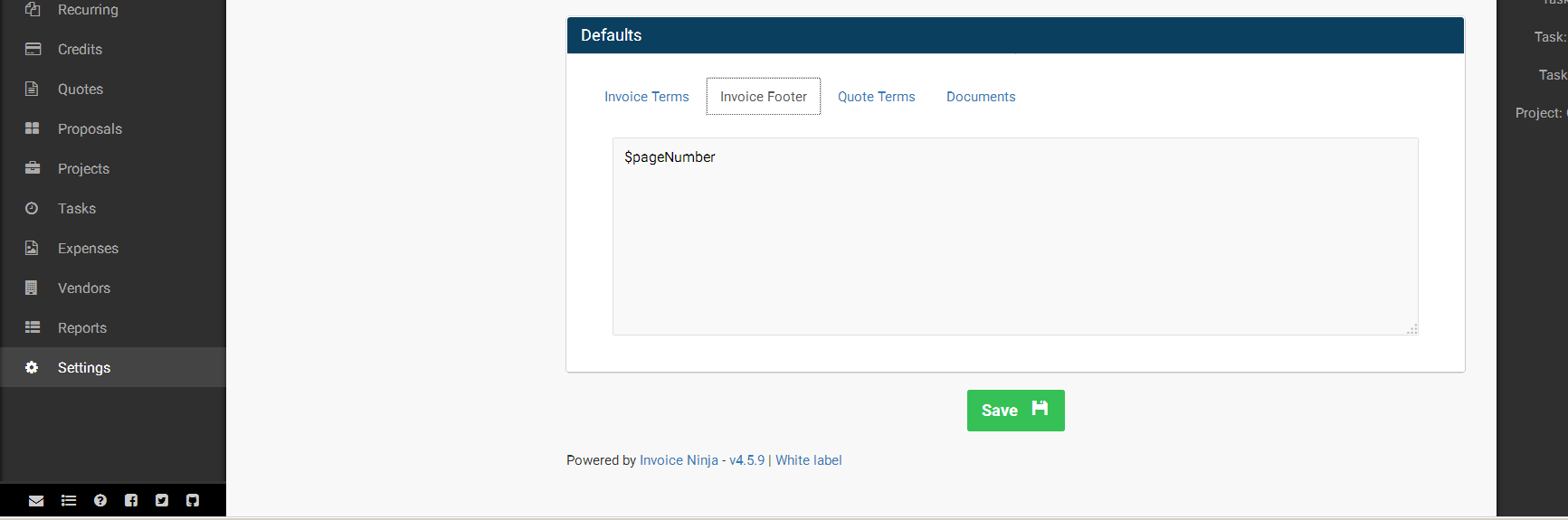

That’s odd, can you post a screenshot?
post a screenshot?
OK, here you go.
The linked image shows no help text you describe (under the “Invoice Footer” tab).
You will also note I have the simplest possible variable entered to test: “$pageNumber” – with no additional text or variables. Even a single variable like this will show the literal text “$pageNumber” (without the quotes) on a generated invoice.
Thanks in advance for any further help or ideas.
I’ve checked the code, it looks like this feature requires a white label license.
