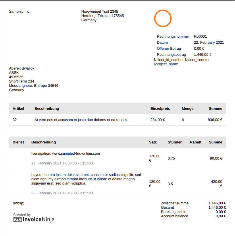

When using the €-Symbol it is prefixed with no space in front of the number in the UI but postfixed in the PDF, which leads to quirky linebreaks (e.g. template “Plain”):

Hello @david, I recently updatet to 5.1.10 and checked the custom field functionality for $project.name and $project.number, but it seem not to work. Do you have any suggestions, why?
I put these in the Designer Content:
Results into this:
In the regular generated invoice the variables appear unparsed.
Hi @david, I have tried without success these variations – all without bouding those two with underscore:
$project.number $project.name
“$project.number” “$project.name”
$project_number $project_name
“$project_number” “$project_name”

@cdahinten After talking with @hillel about this, I don’t think it will be possible to support a direct project variable. the reason is because an invoice can be linked to many tasks which may belong to different projects.
Are you able to use a custom field to display the information you need? then you can use the variable
