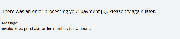

After a troublesome update to v5.11.66, that involved fixing a few fields manually… invoice payments are now causing this error (invalid keys: purchase_order_number, tax_amount) and are not able to process the payment
Steps To Reproduce
client clicks pay on their invoice in their payment portal. payment info is filled out. clicking pay, causes the error.

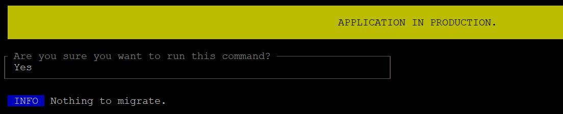

What do you see when running: php artisan migrate
Can you share the exact error you’re seeing?
I’m not sure, I haven’t seen this error before. I suggest asking in a discussion on GitHub, please include the gateway you’re using.
ok, thanks.
could you tell me where these keys are supposed to exist so i can check it they’re there?
I don’t think this error is referring to keys in the database, I believe it means keys sent in the payment request.

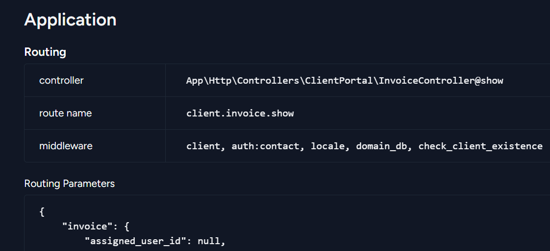

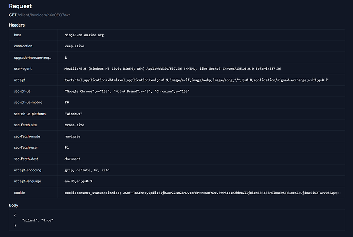

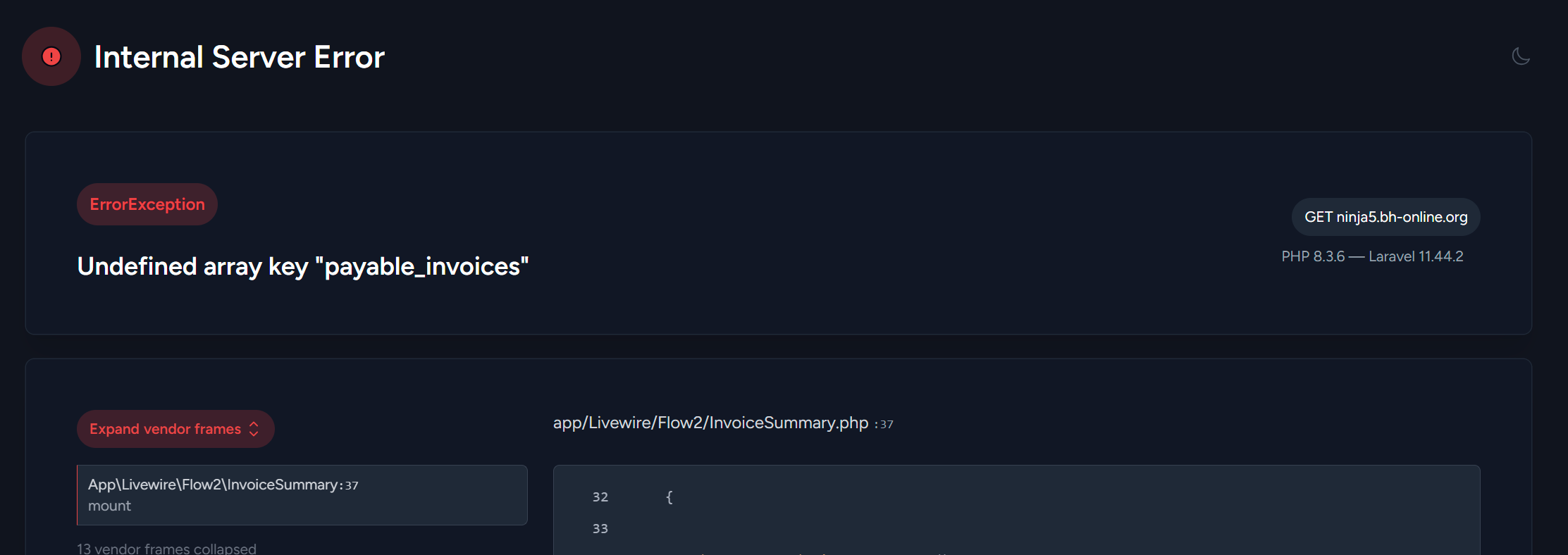

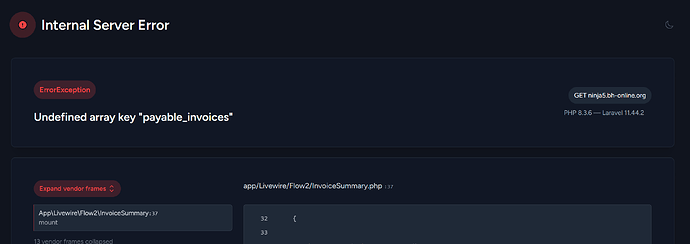

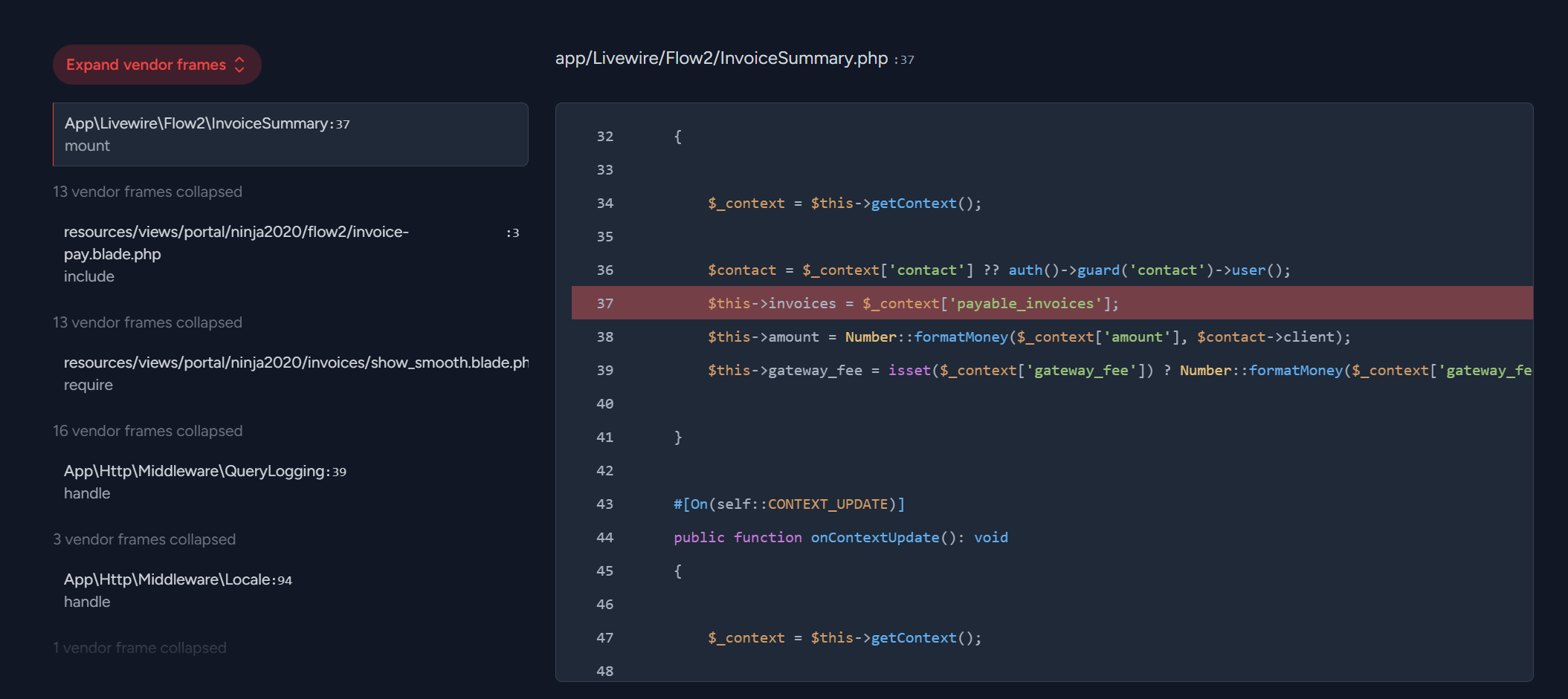

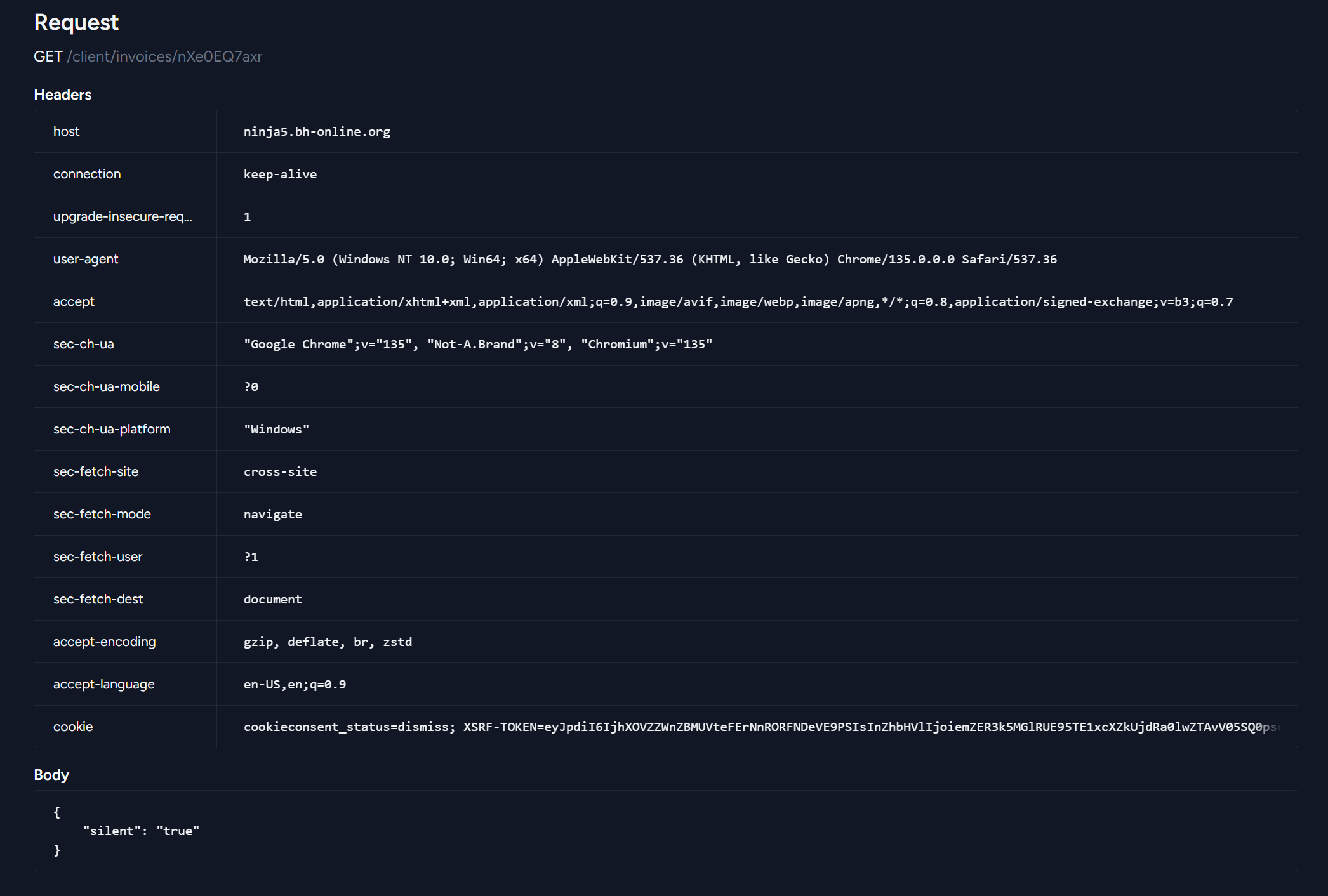

Now this has shown up:
Routing Parameters
    "invoice": {
