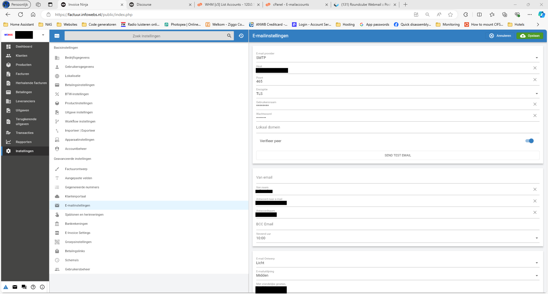

Send a test-mail or send a invoice is working, sending a recurring invoice is not creating an ivoice.

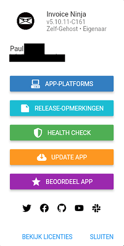

Invoice Version : v5.10.11-C161

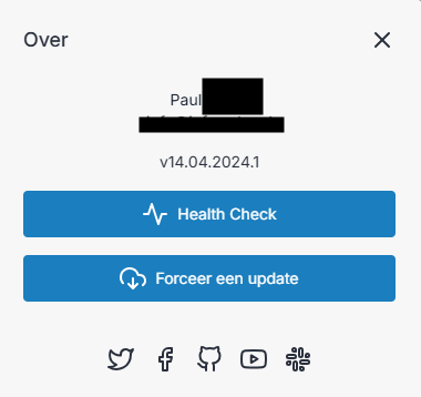

I installed a new, clean install of Invoice Ninja in a test environment but it seems a complete other version now :

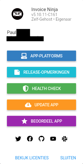

The production environment is this version :
Now I’m realy confused. Please advise. I want my production environment to work.

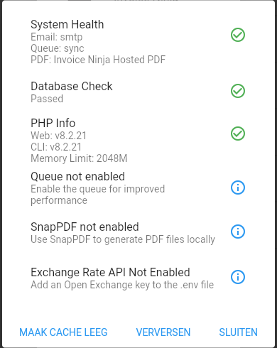

Also, is the queue enabled?
Looks like the queue is not enabled. How can I enable the queue ?
That won’t be the problem, if the queue is disabled the app should still send.
