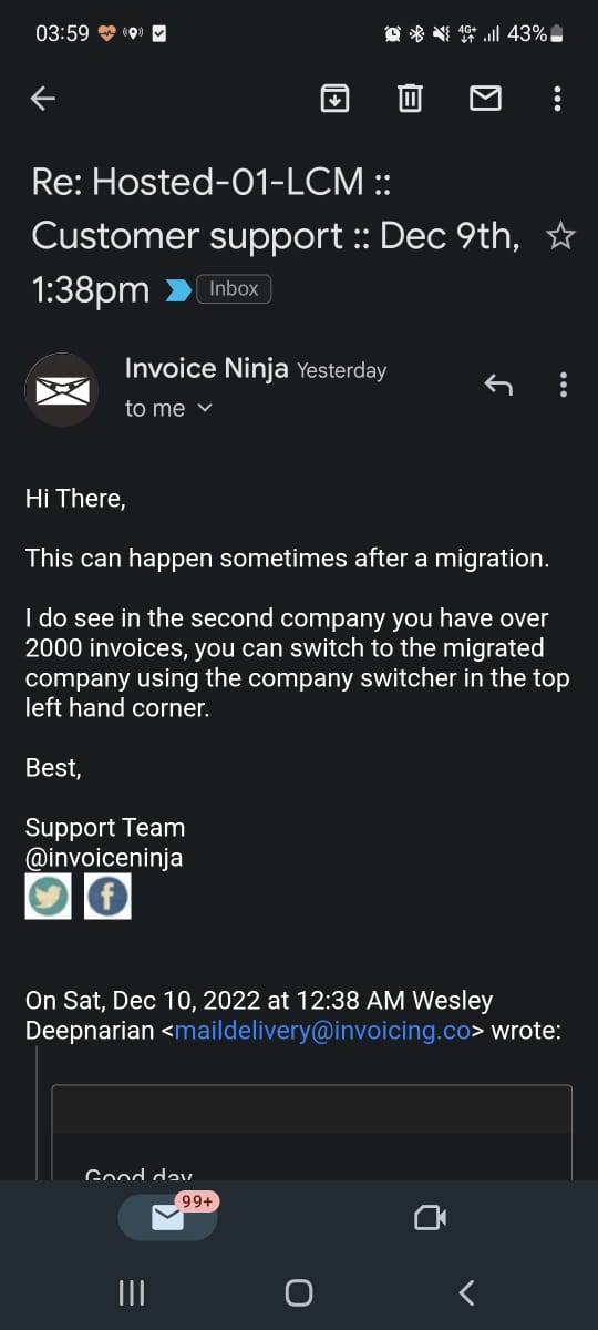

Then I used the start migration and inputted the hosted address into the system. After a few minutes I recieved an email stating migration complete. About 2000 invoices etc. However it does not show up on Invoice Ninja hosted. I emailed support again and the response I recieved was that it is showing in your side and I must switch companies. There’s only 2 companies. One is test. And then a untitled company. When I enter the untitled company it says loading data. And is stuck there.
Sometimes it gets unstuck but there’s no data in that company.

Here are screenshots from email support
On a side note after migration I went back from enterprise to free plan. Support said it happens. Within 48 hours it went back to enterprise.
See screenshots
