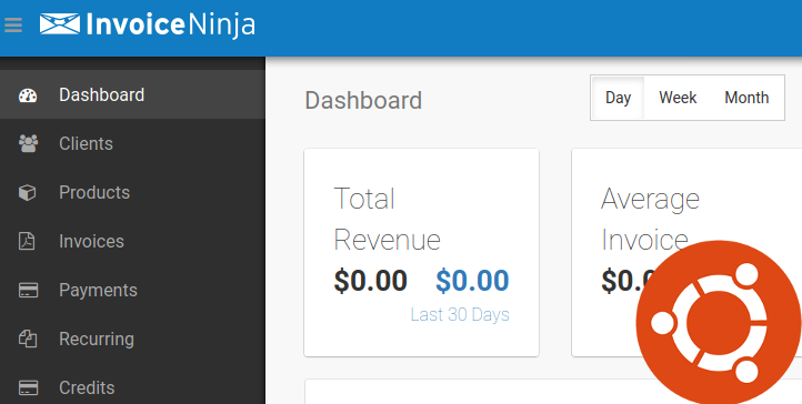

Install Invoice Ninja v5 on Ubuntu 20.04
If you are self-hosting, installing on Ubuntu is the best possible method, and highly suggested. Running Ubuntu as a host allows you to install with the least amount of effort, fewer dependencies, and auto-update the application through the admin portal user interface. The ‘invoiceninja.zip’ package that is compiled by the Invoice NInja team every release has many dependency packages bundled into it, but it is only compatible with Ubuntu, and maybe othe…
