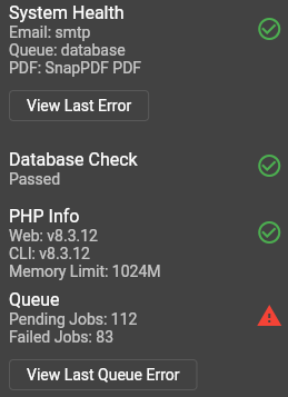

Laravel log says:
[2025-08-18 14:10:44] production.ERROR: Connection refused [tcp://127.0.0.1:6379] {“userId”:1,“exception”:"[object] (Predis\Connection\ConnectionException(code: 111): Connection refused [tcp://127.0.0.1:6379] at /var/www/invoiceninja/vendor/predis/predis/src/Connection/AbstractConnection.php:144)
[stacktrace]
I tried updating to latest this morning, and half way expected something to go wrong because I recently spun up a blank vm of this version and immediately got errors - I was correct.
I will roll back my production vm but leaving this information here so perhaps it can be addressed before next update.
The error occurred when I tried to archive some invoiced tasks. Gave me “500 internal server error”.
Linking the post about the blank vm error on first setup for reference.
Apparently I can not roll back because my snapshots were not firing as of a few days ago. So this is now a lot more time sensitive as I can not invoice or create new work tasks. Any ideas would be much welcome.
