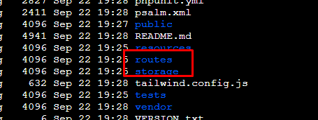

The cron is running as the user alltbilling@server, that is great, however i suspect the content of /home/alltbilling/public_html has wrong file permissions/owner because it was setup by root.
Try loggin in -as root this time- and perform both commands: “cd /home/alltbilling/public_html” then “ls -l” if you see root somewhere there I think that is the problem. Might look into commands as “chmod” and “chown” to fix that, but setting up from 0 (I guess the app doesn’t have usable data yet because the cron never worked) via the alltbilling user would be the way to go as described above.
Thanks for your patience on this.
I logged into WHM as root and ran the commands in terminal, here’s the response. No email received for the task that ran though.
I also went into the directory and no root.

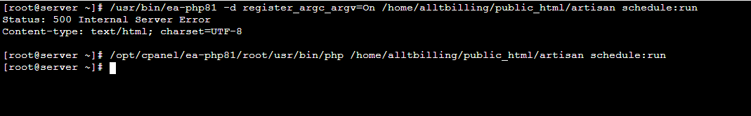

I also tried this from the terminal and no error but also no email.
/home/alltbilling/public_html/artisan && php artisan schedule:run

First of some basic understanding: The email is not generated by the command you perform but by the cron deamon spitting out the output of the command.
/usr/bin/ea-php81 -d register_argc_argv=On /home/alltbilling/public_html/artisan schedule:run is the correct command for your setup INSIDE the cron, wich will spit out the ERROR 500 when performed via the cron to your email. Performing the command manually will spit the output in your terminal.
/usr/bin/ea-php81 -d register_argc_argv=On /home/alltbilling/public_html/artisan schedule:run is correct, inside your cron, you may remove the other one there.
As to why you are getting the ERROR 500, your screenshot does not show the user owning the files, I still believe your file permissions are wrong because you unzipped the app via the root user (I can not be sure because the screenshot does not show everything) and that is why your cPanel interface does not list all the app files and the command performed gives the ERROR 500 because it cannot access all files needed.

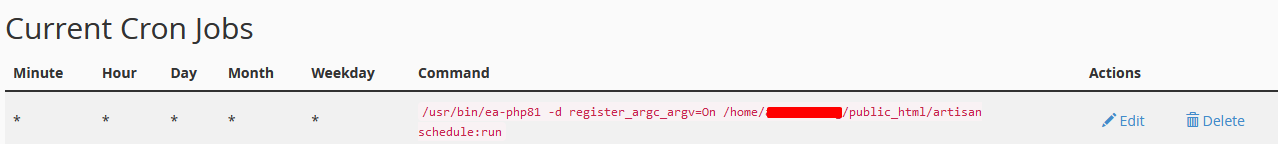

Setup the cron job

The cron should be set in cPanel of the newly created account, not as root obviously, having
          • /usr/bin/ea-php81 -d register_argc_argv=On /home/NEWACCOUNTNAME/public_html/artisan schedule:run
Change NEWACCOUNTNAME to the user you (re)created. After making any changes to your cron setup you’ll want to force a recheck of the cron setting. To do this navigate to http://url/update?secret=

Could you please try to set the cron again and force a reset again using steps above with cron set as this path (including local):
          • /usr/local/bin/ea-php81 -d register_argc_argv=On /home/ACCOUNTNAME/public_html/artisan schedule:run
Make sure on the cron settings page inside cPanel an email is set, you should be getting mails each minute to the email address set there, if not there realy is a configuration error with the cPanel server itself rendering me out if idea’s.
If it works remember to add >> /dev/null 2>&1 after the command to stop receiving the email every minute.
          • /usr/local/bin/ea-php81 -d register_argc_argv=On /home/ACCOUNTNAME/public_html/artisan schedule:run >> /dev/null 2>&1
PS: Offcourse again edit ACCOUNTNAME to the account the invoice ninja app is on
