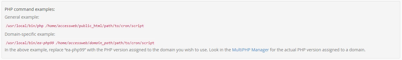

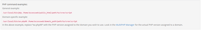

on cPanel I use: * * * * * /usr/bin/ea-php81 -d register_argc_argv=On /home/accessweb/public_html/posv2/artisan schedule:run >> /dev/null 2>&1
Edit ā€œea-php81ā€ to the PHP version your domain/subdomain uses in cPanel (see MultiPHP Manager) for what version, if it is 8.0 it should be ā€œea-php80ā€. Also edit ā€œ/home/accessweb/public_html/posv2/ā€ to be the directory where your v5 installation is located (you will find an artisan folder in it then the path is correct). See screenshot for the manual cPanel itselfs provides when creating crons.

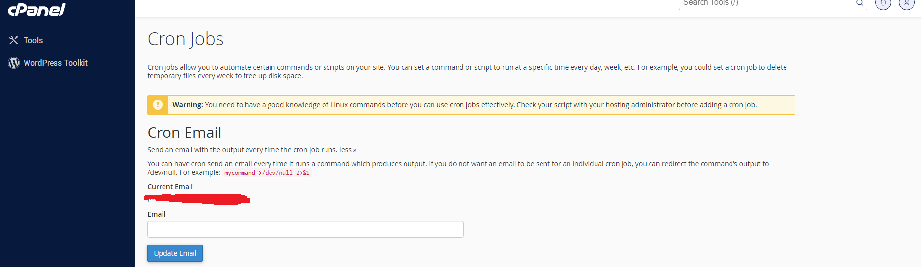

In your cPanel for the user account (NOT the WHM interface if you have access to that on the server) search for ā€œCron Jobsā€ and click it. Set the email address there where emails should go about the cron’s. It’s on that page. See screenshot. You should be receiving mails then every minute, anyhow the triangle should be gone by now too?
