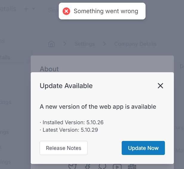

I tried updating but just got the error “Something went wrong”.
Hi Hillel
As above I tried to upgrade and got an error. I also do not know where the one page checkout option is.

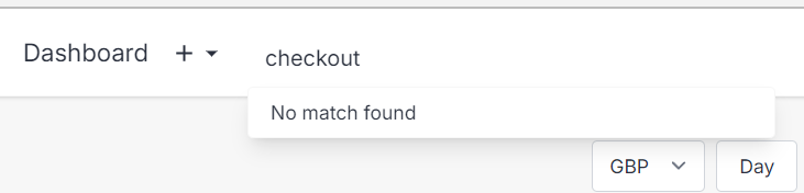

In the desktop/mobile app you can search the settings to find specific options
I tried that.
Am I using the right search tool?
And why mark the topic as solved when it clearly isn’t I don¡t understand.
Please read my comment again, the screenshot is from the mobile app
Hi Hillel
I took that screenshot from the web app.
I meant to write web app, the settings search feature is supported in the desktop/mobile app as explained above
