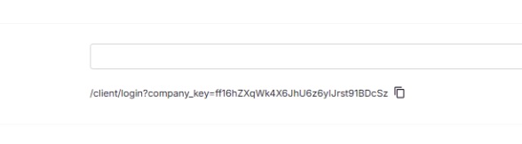

The internal app docs are not showing the correct format:
http://domain.com/client/login/XXXXXXXXXXXXXXXXXXXXXXXX
it isn’t a query parameter, it is just part of the URI.
We’ll update the examples in the app…
Thanks David, anything I can do to fix this?
if you use the format as above this should resolve the issue
Thanks, just tested it that way and it worked. Ill see where I can update this.
Currently this is set in settings.
