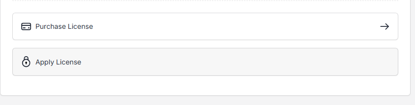

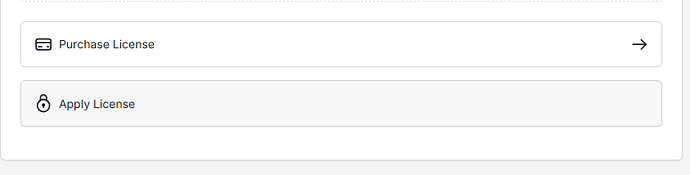

just add it into the system using the gui. Go to Settings and the Account Management and then click “Apply License”
You’ll then see the above change to “Licensed” and provide an expiration date. Reload the GUI and then you’ll see the white label button disappear.
