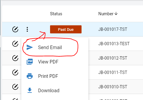

If I sent an invoice for the first time after it been created, I get webhook call, but if I have to sent it again after been sent oonce, I don’t get webhook call.
If I sent it as a reminder it does not get called either
@david is the ‘Sent email’ webhook called each time the invoice is emailed or just the first time it’s marked as sent?
@hillel
Only the first time.

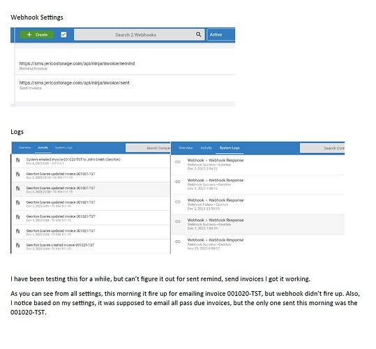

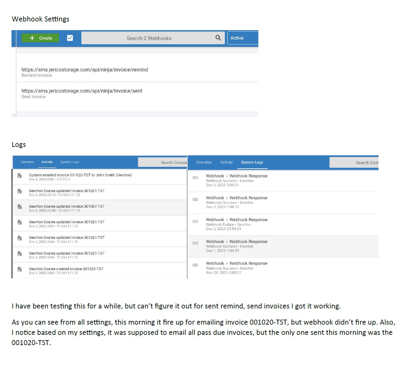

Hi
I really need your help on this, please.

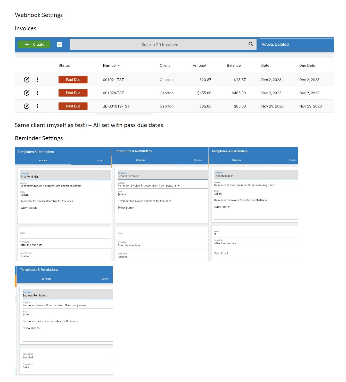

Here is what I have done and working
webhook when send invoices. done and working proper.
webhook when reminder is email. Not working (I need help understanding how this works, when it get fireup)
I attached pictures below refrerence to my system settings.
Thank you
You’ll want to wait for the next releaase for the webhooks to be sent on eachemail event.
Also note, reminders are only sent if they have not been sent previously. So if you manually send a reminder 2 email, then it will not fire again.
