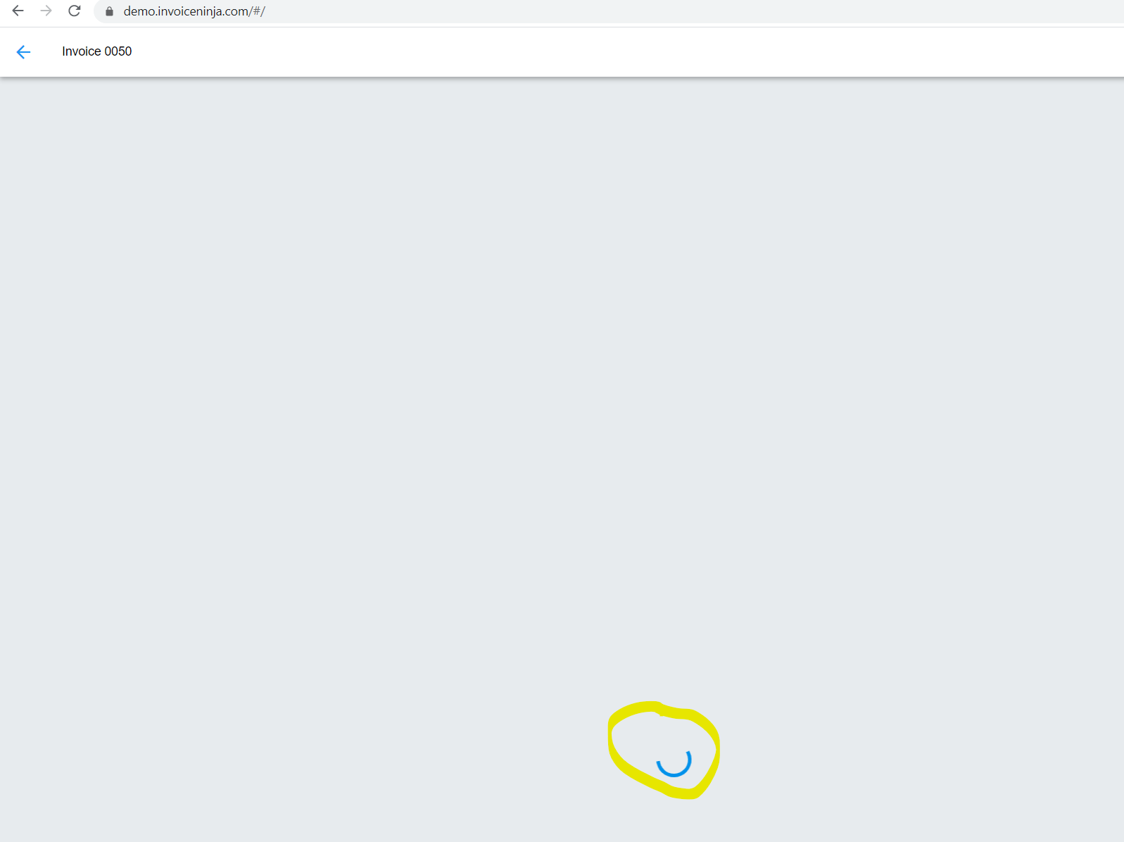

View Invoice as a "PDF" hanging
I thought this was just my installation but when i visited the demo.invoiceninja.com to view an invoice there i got the same result. The loading icon just keeps spinning and nothing happens. Is there something i’m missing here??
Are there any errors in the logs in storage/logs
I sent you a picture of “demo.invoiceninja.com” I can’t see your logs. But its doing the same on my site as it is on yours!!
Can you see this?:
If you’re able to send details from your error logs it would be helpful.
The demo server is a strange setup as we constantly refresh the database, it’s unclear if it’s the same problem.
