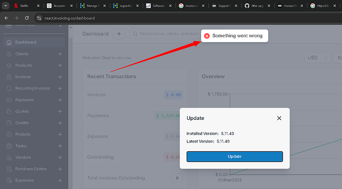

Upgrading On Shared Hosting - Error
Hosted Version:
Installed Version:
5.11.41
Latest Version:
5.11.49
Tested on Invoice Ninja
Version slightly different but same issue
Installed Version:
5.11.43
Latest Version:
5.11.49

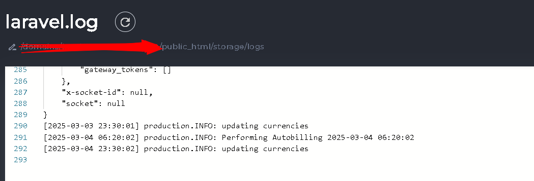

Checked the los no errors in the laravel.log
Let me know if I am missing something.
Replicated the steps in order to generate log files.
I also noticed before I could do the upgrade in the Softacoulous panel but see that is no longer there.

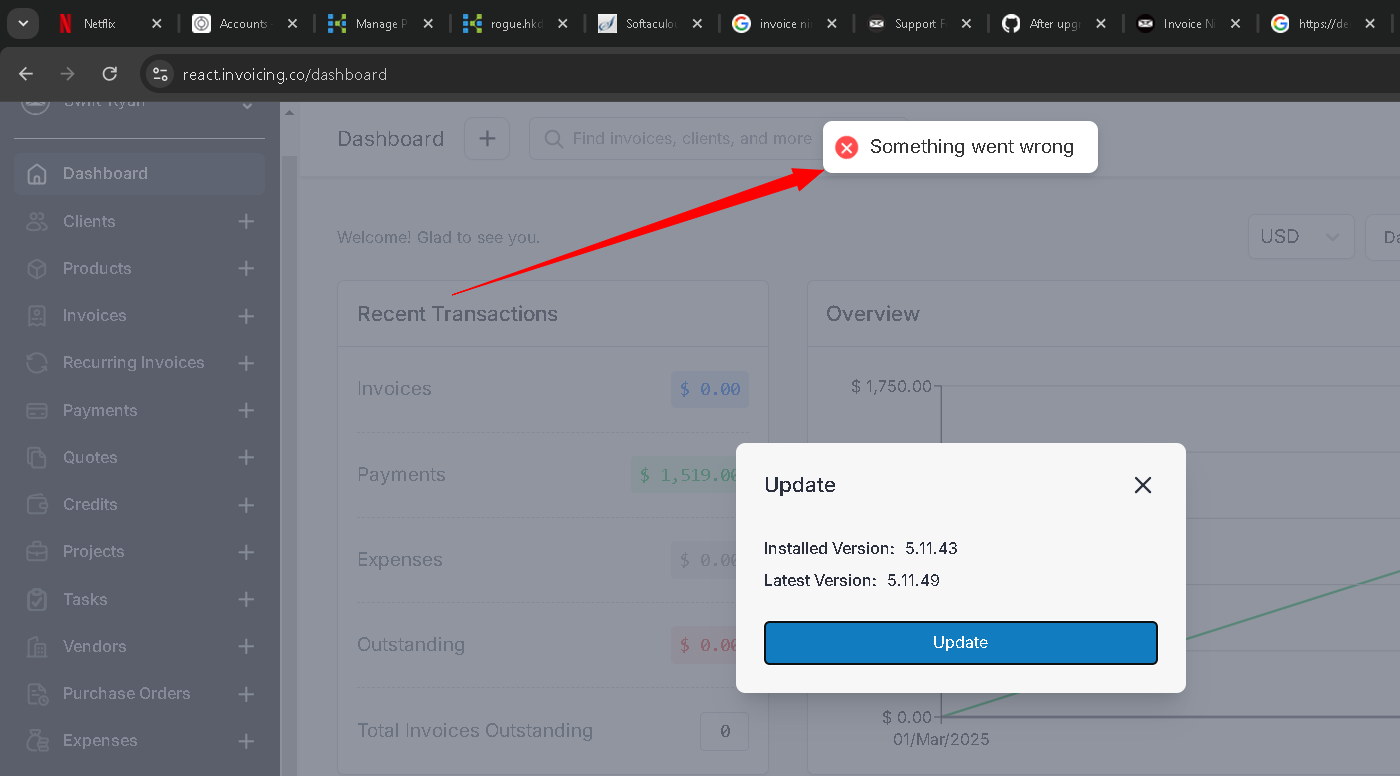

Are there any related errors in storage/logs?
hi @hillel
There is nothing in the storage logs.

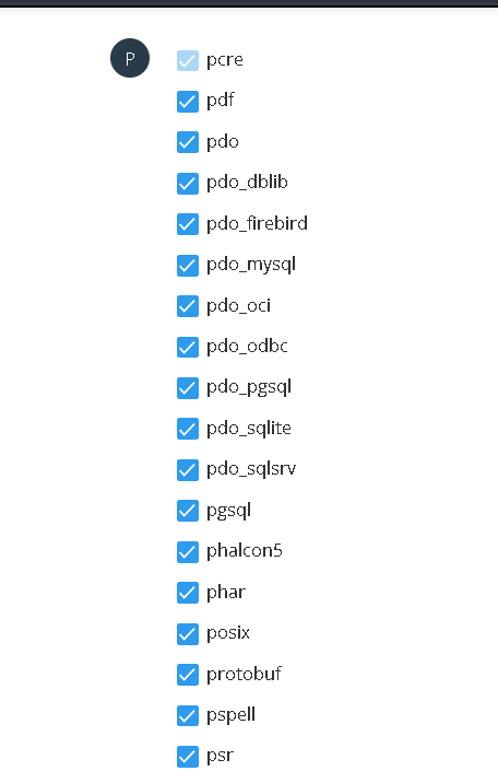

However I have enabled them on the PHP version.

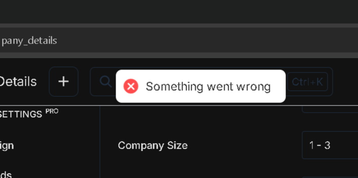

Ever since I’ve been exploring Invoice Ninja on a quality AU Hosting server, I’ve always experienced these issues “Something went wrong”
I’ve become reliant on Softaculous to Backup and Update.

Currently chatting with hosting provider, so not sure if it will make a difference but I have identified the following module is not installed * common on php.
Currently diagnosing to see what the issue is.
@hillel just want to ensure I am correct path with regards to the modules.
Also wanted to know how come Softacoulous dont have the update option, is there a delay?
Sorry, I’m not sure I understand your question related to modules.
Yes, Softaculous usually has a short delay as they need to test the release.
  • I wanted to verify which php modules are required. My apologies.
I am currently testing with the hosting provider to find the root cause, so if we may keep the thread open. Will post results once it has been fixed.
I asked my AU Quality Hosting Privider the exact same question a little while ago. Here is their reply :slight_smile:
"The ‘Common’ PHP extension here is essentially an indication of the extensions, licenses, and support files that are installed within the php-common package, which are installed and utilised by your current PHP installation
Rather than the requirements listing every single one of the PHP extensions that are installed within this package, the requirements list these as ‘common’
So in answer to your question, as the extensions that you will require within this package are already enabled, you will not have issues"
