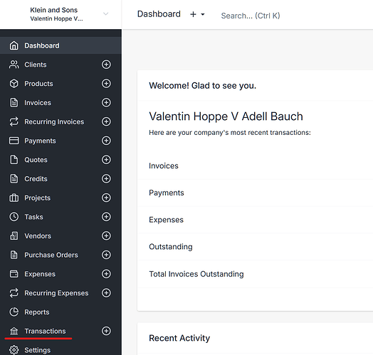

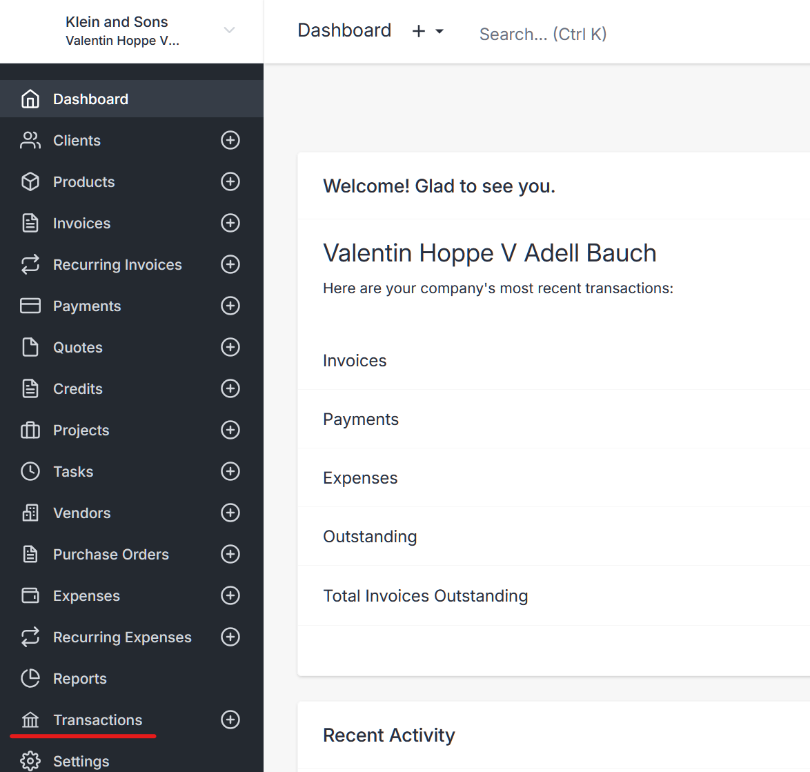

@george3430 if there are changes you’d like to see made in the React web app please create a new issue here:
Invoice Ninja: Web admin portal built with React. Contribute to invoiceninja/ui development by creating an account on GitHub.
@Gaetan please create a separate post

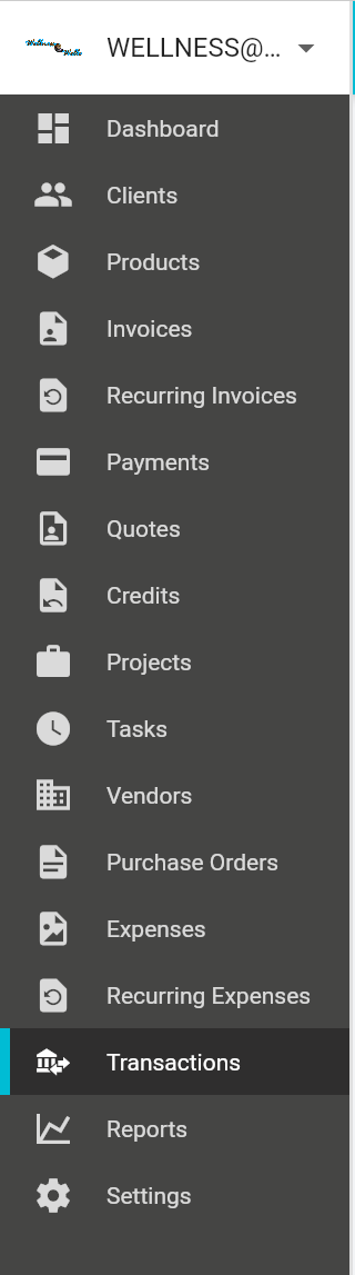

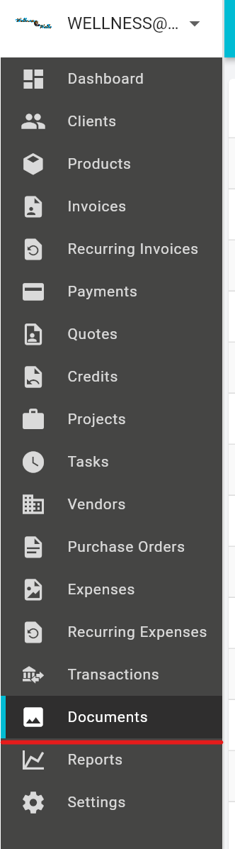

@george3430 I have the desktop app installed and can confirm that both Transactions and Documents exist and are usable in the app.
