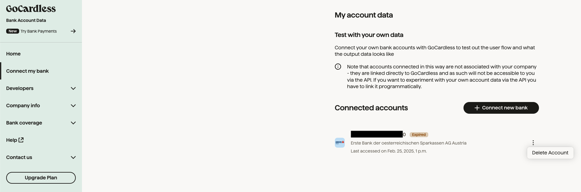

Status of the Nordigen (gocardless.com) connection is “Error:: End User Agreement (EUA) 574773b1-ce87-428a-882b-ffd152bc8057 has expired”. Previously there was always a red triangle next to the bank account which allowed me to renew the permission to get transaction. but this time there is no such triangle

Do you see any options to accept the EUA in the GoCardless portal?
unfortunately not. i can only delete the account.
