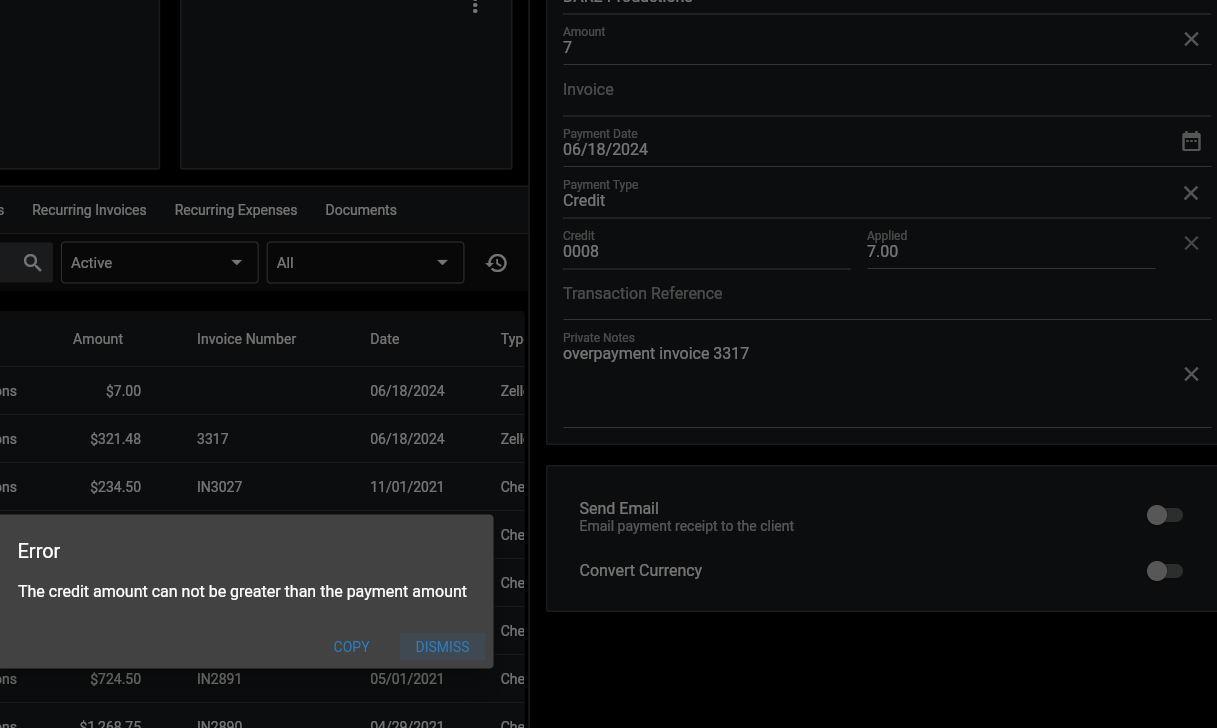

To compensate I have added a $7 credit to the customer, then attempted to link a corresponding $7 payment to it. With the payment amount at 7.00 and applying the credit of the same amount 7.00, invoice ninja tells me that “Error, The credit amount can not be greater than the payment amount.”
But the amounts are literally equal.

Can you please share a screenshot of the edit payment screen where you’re seeing the error?
There you go.
Thanks, it looks like you haven’t selected an invoice to apply the credit to

Perhaps the issue was that I could not create a payment before because the option “Admin initiated payments” was not enabled in my interface when I was trying to figure this out. So the amount field was not showing up in the interface when entering a payment to correspond with this overpayment. Which is why I ended up creating a credit, and now have a credit and a payment -which appears not to be necessary.
What are credits used for? Refunds? Or if you want to put value into a customer account without them having actually paid?
It appears that I can apply the payment directly to an invoice now that it exists. I think my problem before was that I was fishhing for what the correct procedure to record an overpayment was, because the interface was missing the “amount” field with that “Admin initiated payments” option off, so I couldn’t enter the missing $7 without there being an object to tie it to. Which is why I created the credit. Thinking that might allow me to enter the payment. But that did not help.
I got it now.
You can enter a payment that is unapplied, as long as the toggle “Admin initiated payments” in Settings - Payments is on.
Then that payment can be applied to a future invoice.
Hope this helps someone else confused about what happened to their payment amount field, which used to always be there, then suddenly disappeared.
