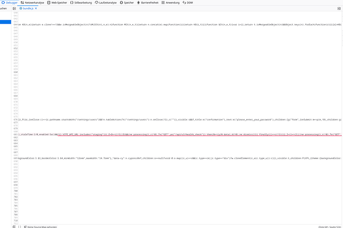

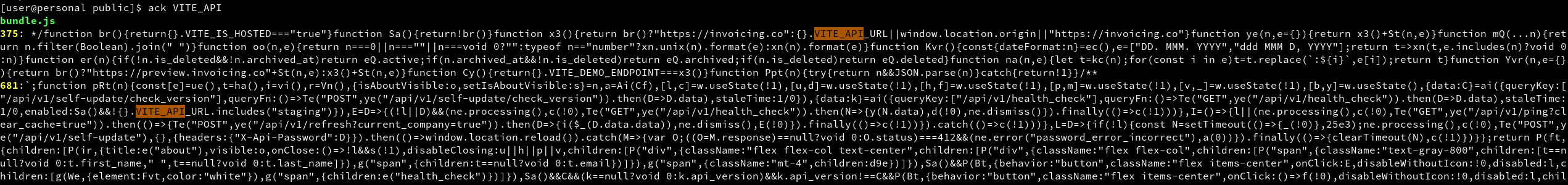

maybe this helps, it comes from bundle.js:
-rw-r--r-- 1 1500 1500 6.1M Jul 8 00:00 bundle.js
~/ninja/dockerfiles/docker/app/public
bundle.js seems to be a version from tonight.
These assets are fetched by the self-update job, right?
Maybe the build process has built under staging or local environment?

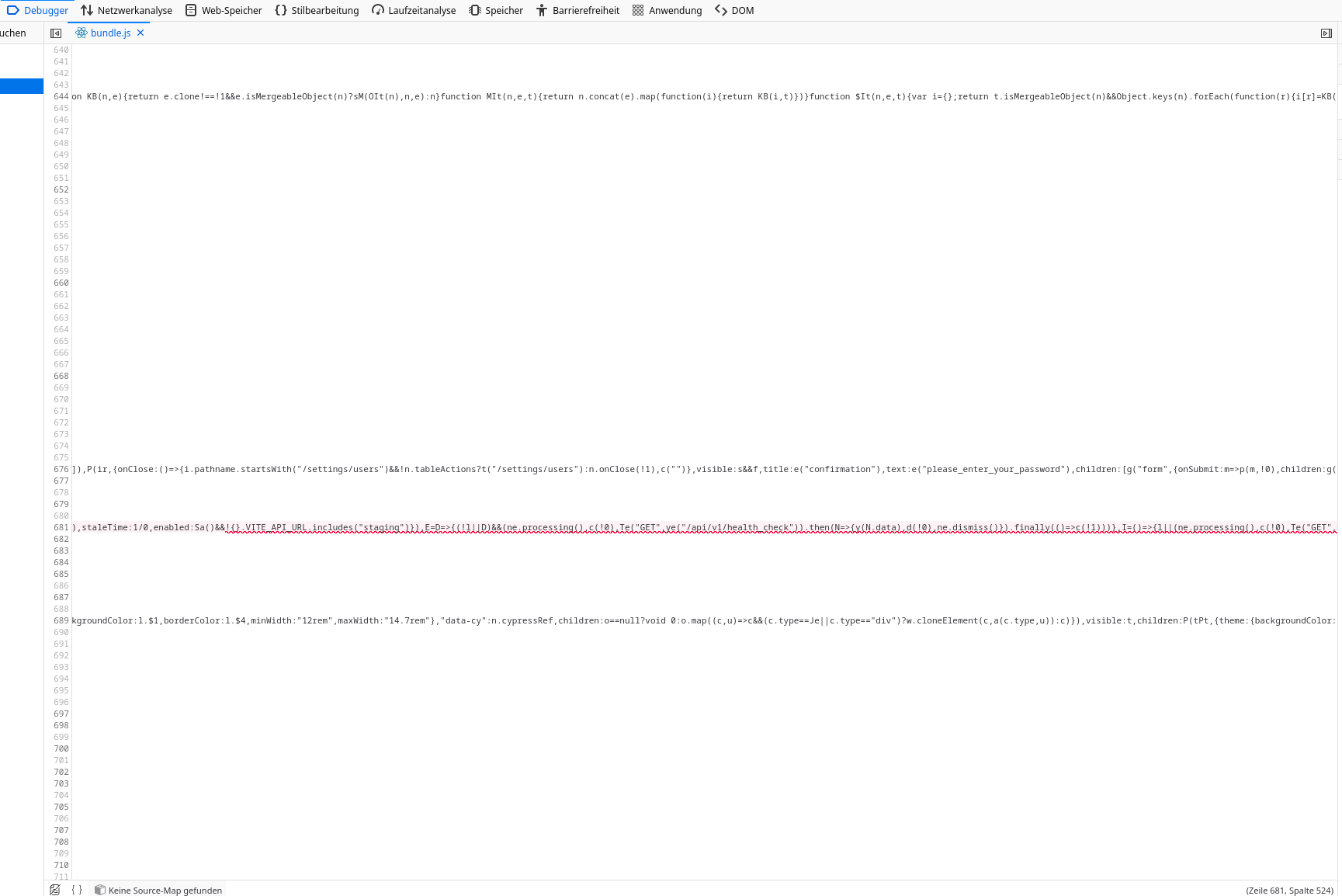

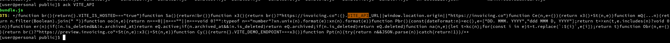

I wanted to know how the versions of bundle.js differ and maybe you can recognize something.
v5.10.4
compared to
v5.10.5
I think the new .includes() will break the whole thing.
