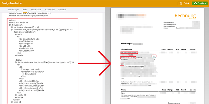

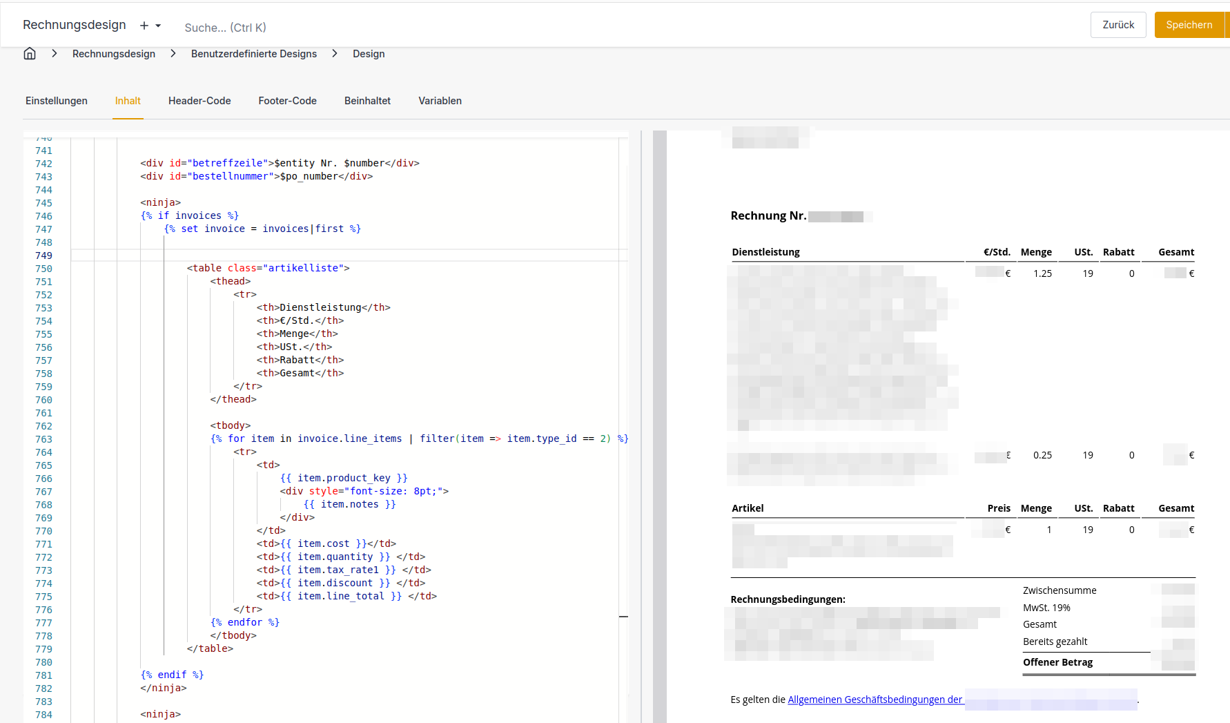

finally I got it work! I can create tables with tasks and articles within invoice-designs using Twig. Buuuut there are two problems. The first one is this thread about.

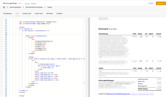

As you can see in the screenshot there are little spaces between the bottom-borders of the table-(headers). Any ideas?
I have to mention that I put the zoom of the html to 100 %. I hoped for sharper fonts and I didn’t understand why some designs use just 80%.
Maybe one can help. Thanks!

Nope, I’ve already set testwise margins and paddings explicetely to zero. No difference.
For me it looks like the whole -table-code is kind of zoomed out.

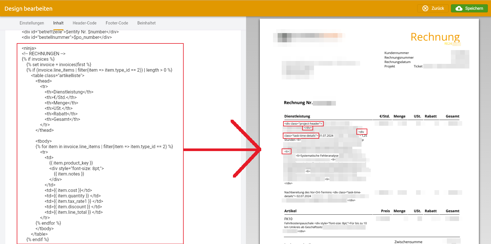

Ah, maybe you’re not so wrong at all, David. What I didn’t recognize as a maybe connected problem is that the item-notes are prompted with it’s special
-tags. So project-header, task-time-details or special font-settings via css-style-sheets within the notes themselves won’t be recognized.
Is this a “wanted” behavoure?

What I meant is: One is creating an invoice which includes the task-table as a TWIG-coded table. It grabs the variable {{ invoice.item-note }} which contains of this string: “Just a rendom task
Some more details about this task
Instead of filling the table-line with this item AND formating the string by it’s involed
-stylesheet, within the --code those stylesheets within the string won’t be shown as a formated text but as the code itself.
Have a look:

Oh dear, found the/my mistake:
Had to set cellspacing-, cellpadding, border-spacing-setting for the tables to 0 and border-collapse-css-option to collapse, so the gaps will disappear.
