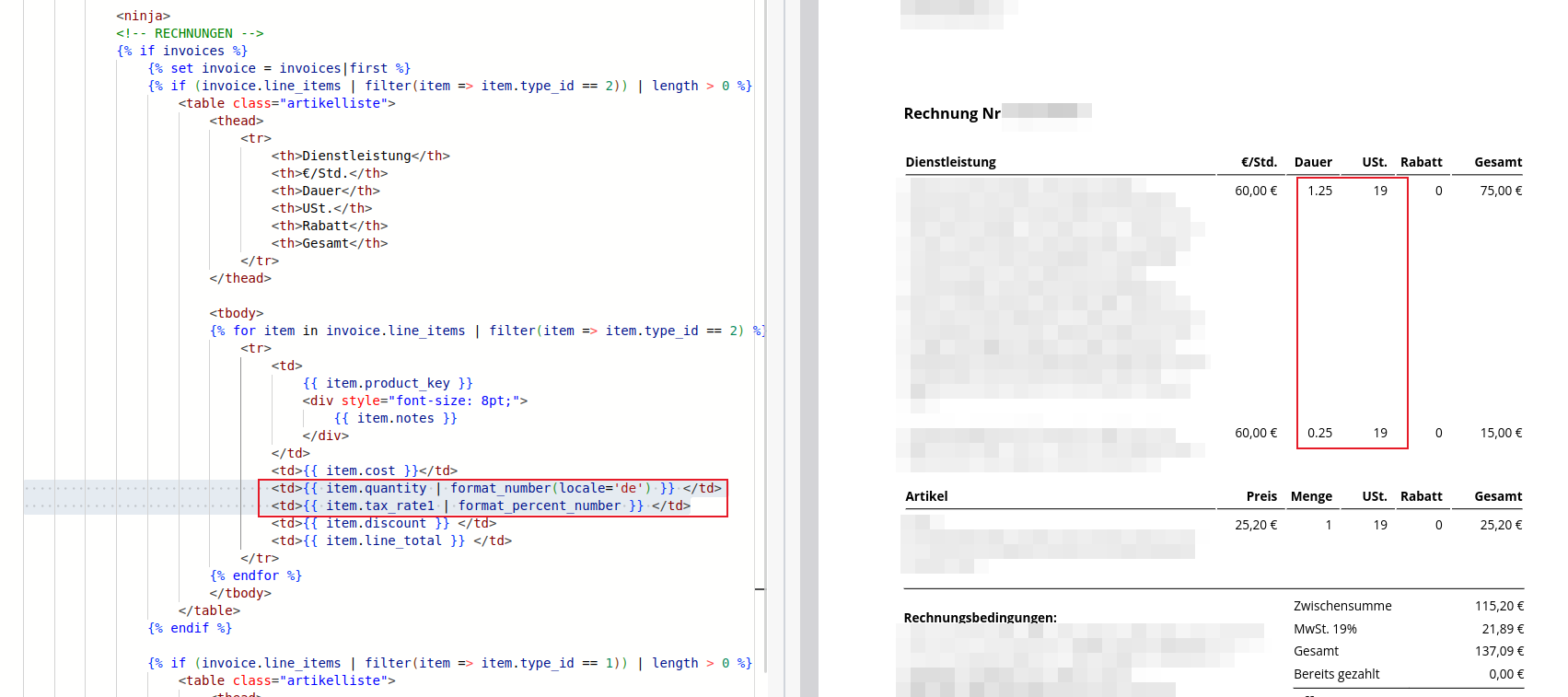

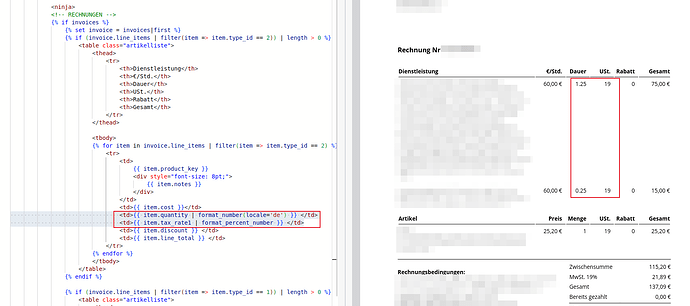

@david
Somehow I’ve still have problems with the format_number-filter. Setting up to “locale=‘de’” doesn’t effect the number. Still its decimal-icon is a dot, not a comma.
Have a look:
EDIT: Ah, but I forgot that format_number(friction_digit: 4) works as exspected. Weird!
