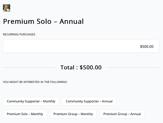

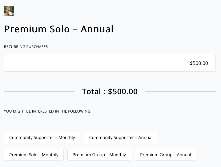

  1. There is a “You might be interested in the following” with links to the other products in the group. Can this be removed/suppressed? Once the person has decided on a plan and is ready to pay for it, they shouldn’t be offered options.
  2. The price is indicated twice which feels repetitive when there is only one product on the payment page. Is there another UI that I can switch to that just includes the price once?

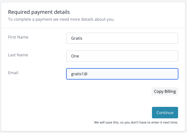

  1. Once you click through to pay via stripe credit card, the “Required payment details” page requests the information I’d expect to ask - First name, Last name, Email. And name is prefilled from the previous page whic hhelps. But it also displays a stray “copy billing” button. I can’t figure out how to suppress that.

Just doing some testing and came across the issue below again. I’d love to find a way to skip this step and go straight to the actual Payment Methods step. Is it possible?
If not, I’d like it to go ahead and request full contact details including street and country. Asking for partial contact details is quirky and unsettling to new clients.
Grateful for any guidance!
Sorry, I don’t believe this is currently supported. If you’d like to see this changed in the app I suggest creating an issue in GitHub.
Done! Payment link/subscription page feature request: don't ask for name and partial street address on payment method step · Issue #12221 · invoiceninja/invoiceninja · GitHub
The github issue I created has been locked so I can’t follow up there, with this explanation:
Some gateways have a minimum set of required fields that must be filled in prior to submission of payment, without those fields the payment won’t be able to be initiated.
I understand that. But the required information is requested at the next step already, at least with stripe. I would be ok with asking for all the information at this first step but it is bizarre to only ask for incomplete information here. Multiple people I have watched using this payment link have been confused by the UX here.
This is bad enough that I am considering alternative options to invoice ninja before launching my online business. Pity if this can’t be resolved, and I think it is an issue that affects everyone trying to use payment links.
The issue was converted into a discussion, you can follow up here:
