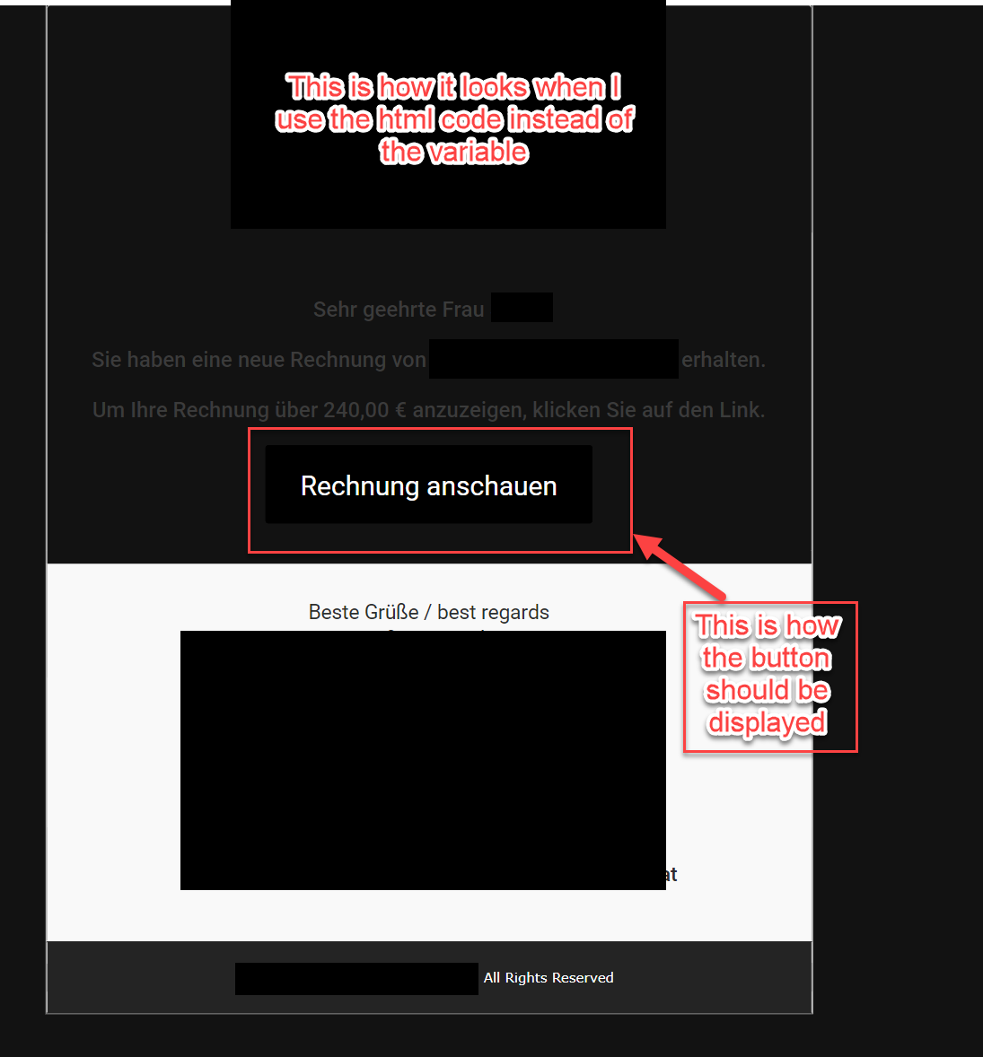

The variable "$view_button" is just showing the html code
The problem is that when I go to templates and reminders and look at the preview its not showing the view button it is just showing the html code. When I then take this html code and paste it to the place where the variable “$view_button” would be its working. Im attaching pictures so you know what Im talking about. My question is if there is a way to fix the variable so I can use it ?
It may help to check that email markdown is disabled on Settings > Account Management.
@david do you have any ideas?
this bug was in 5.5.71, it is fixed in 5.5.74
