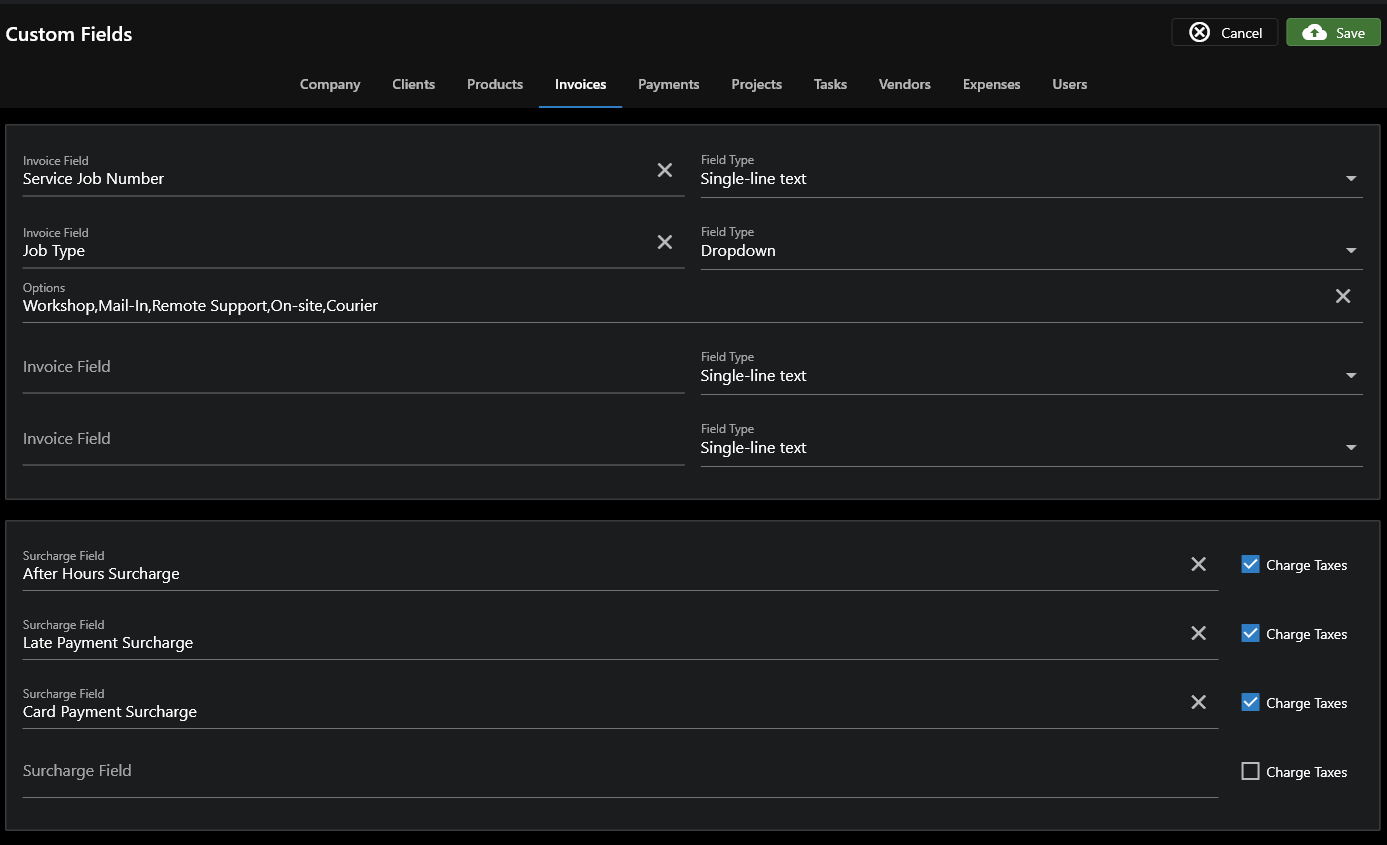

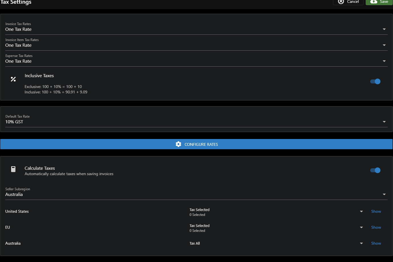

I have the following tax settings and “charge taxes” is ticked for a custom field.
However, when creating an invoice, the tax amount for the custom field is not displayed.
I assume this is because I have Invoice Item Tax rates enabled instead of Invoice Tax rates and the custom field is not being included.
Is there any way to display the tax rate for the custom field the way I’m wanting, or is this a bug?
The total is correct as I have chosen inclusive taxes, however I want the GST charged to include and reflect the GST included in the surcharge (custom field).

is this a custom field, or a surcharge field?
It’s a surcharge field under Custom Fields > Invoices > Surcharge Field

One of the problems here is that the surcharge uses only the invoice level taxes (not the line item taxes) that have been configured on the invoice.
I can see here you have line item taxes, and no invoice level taxes?

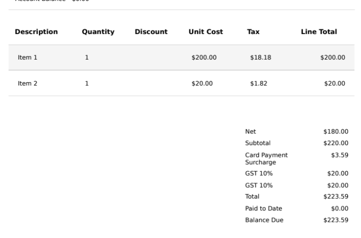

There’s definitely a bug here in my opinion.
I have enabled Line item taxes and invoice level taxes to test, and I have inclusive taxes enabled.
I created a new invoice.
You can see in this example we get the tax amount in the line items, as we want, and this totals $20 of GST. You can also see that I have $3.59 in the Surcharge field, and I have “Charge taxes” ticket for the surcharge field.
There are two issues:
  • The surcharge has “Charge taxes” ticked, but the taxes from this $3.59 surcharge (0.33c) are not added to the GST summary.
  • GST 10% is displayed twice in the summary.

did v4 add the surcharge taxes into the totals summary?
Should it not be in the summary? If you have a surcharge field and you are ticking to charge taxes, and have inclusive taxes enabled, where else would it be displayed other than the summary? Currently it’s not showing that the surcharge includes GST and for how much (through the summary).
Also not sure why GST 10% is showing twice.
