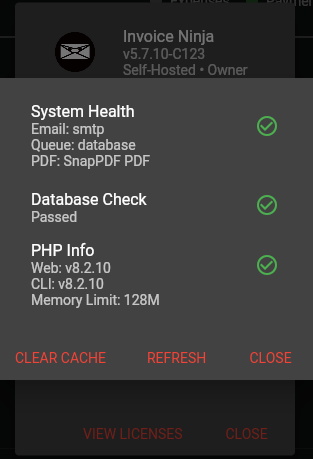

Which version of the app are you using?

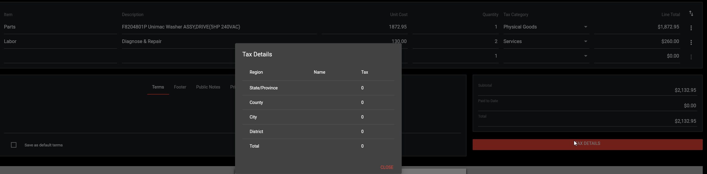

From the screenshot above it looks like the tax address isn’t recognized for the company or client, we’ll look into making this easier to track down in the app.
I had a suspicion about it, which way to look to verify?
I’ve entered multiple clients, same city, different street address. No taxes for all of them.
There isn’t a way to check directly in the app, we’ll work to improve it.

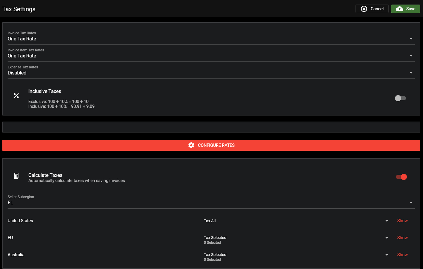

Are there any users out here that has this working on self hosted setup?
I believe you’ll need to obtain a key from ziptax
We’ll look into adding a message about this in the app.

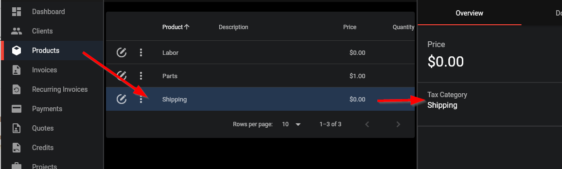

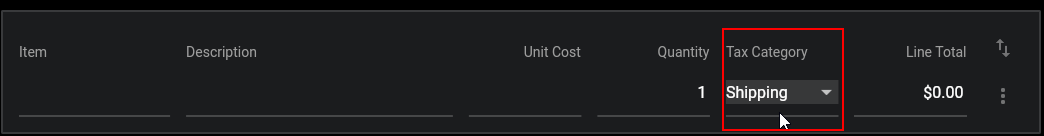

I need to get a mandatory paid service to be able to distinguish predefined shipping category in the line (quote/invoice) from the rest of the lines to not charge tax on it?
That is a bit “overkill” don’t you think?

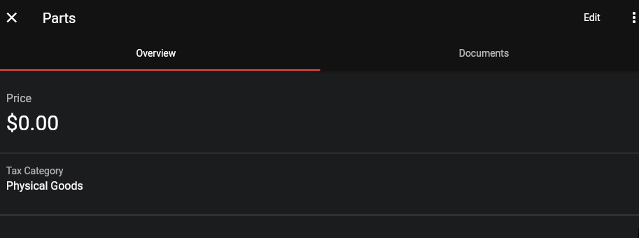

I’ve tried setting up products, thinking maybe tax calculation is not triggered until there are products. And you can clearly set type of product in there.
As well as in the invoice itself.
Shipping is just an example, I’ve tried all product categories and different combos of them.

If the rate is set for the product you can disable the auto-tax feature and set the default tax rate on the product itself.
In my case, the product is labor. Parts in the invoice can’t be catalogued within products module, because they are different every time.
So I created a pretend product to see if I could trigger the line tax calculation this way. It didn’t work.

If you’re working in the US you’ll need to either get an API key from ziptax or disable the auto-tax feature. Sorry, it depends on an address lookup feature which requires the API.
Hilarious. So if there is anything wrong with communication or uptime for 3rd party - kaput.
I imagine these 3rd party APIs are pretty reliable, but yes… if the API is down the feature wouldn’t work
