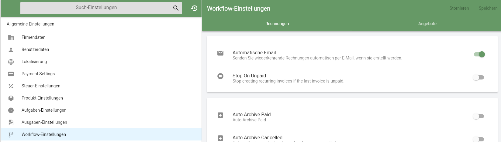

My cronjob runs every minute php artisan schedule:run
and the workflow for “automatic email” will be enabled:
So why I see the message “Queue not enabled”?

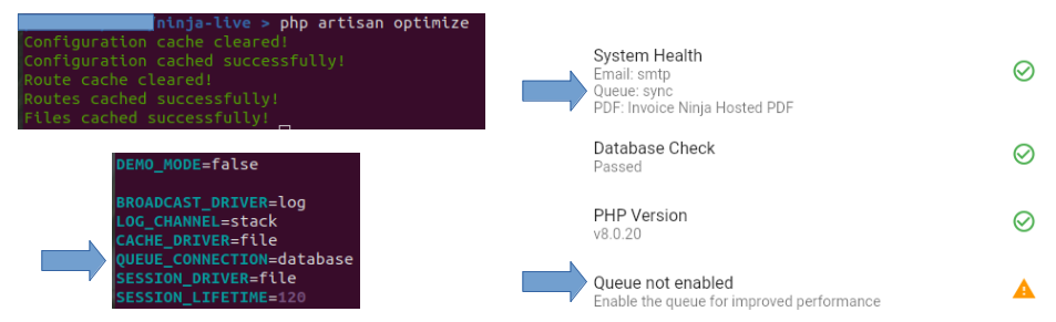

The parameter QUEUE_CONNECTION=database in “.env” will be set and both cronjobs are running:
grafik
But nothing will be changed in “System check”:
grafik
Try running php artisan optimize
Also no change:
grafik
Is it possible you have more than one QUEUE_CONNECTION value in the .env file?
No, there is only one:
