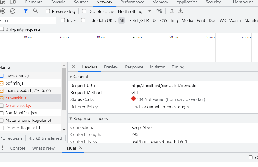

In the network tab are all requests loaded correctly?
You may want to try with the desktop or the React app by setting set_react_as_default_ap to 1 in the accounts table.
I’ll try the React App.
as regards the network tab…
Is APP_URL set correctly in the .env file?
I guess not. I originally set it to the correct ‘final’ url once I have it up and running.
However, I’m only wanting to set this up for local host at the moment to validate all the processes. What would the APP_URL be set to for that to work on localhost? Like this?? ===> http://localhost/invoiceninja
It may need to be http://localhost/invoiceninja/index.php, ideally it’s better to remove index.php
Thank you. All sorted now. Best regards
