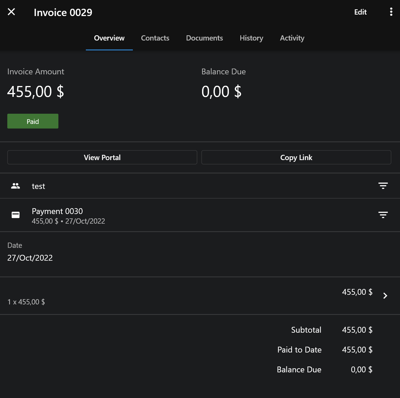

I tried a few operations on a test company and I’m not sure Invoice Ninja behaves exactly as you describe regarding deleted paid invoices. For instance, here is an invoice I just created and marked as paid:

The thing is, in this test, deleting a paid invoice and restoring it did break something, as the interface would not show the restored payment and the invoice as linked together, even though they were still somehow linked under the hood. In my real case, the glitch was worse, because the payment was never restored, yet the invoice was still marked as paid, with no payment that I could associate with it, since it was deleted “for good”.
