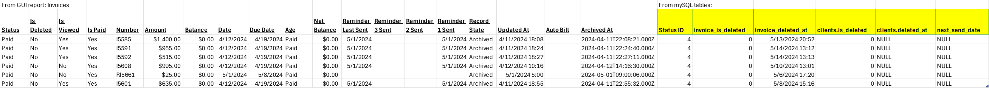

the six invoices:

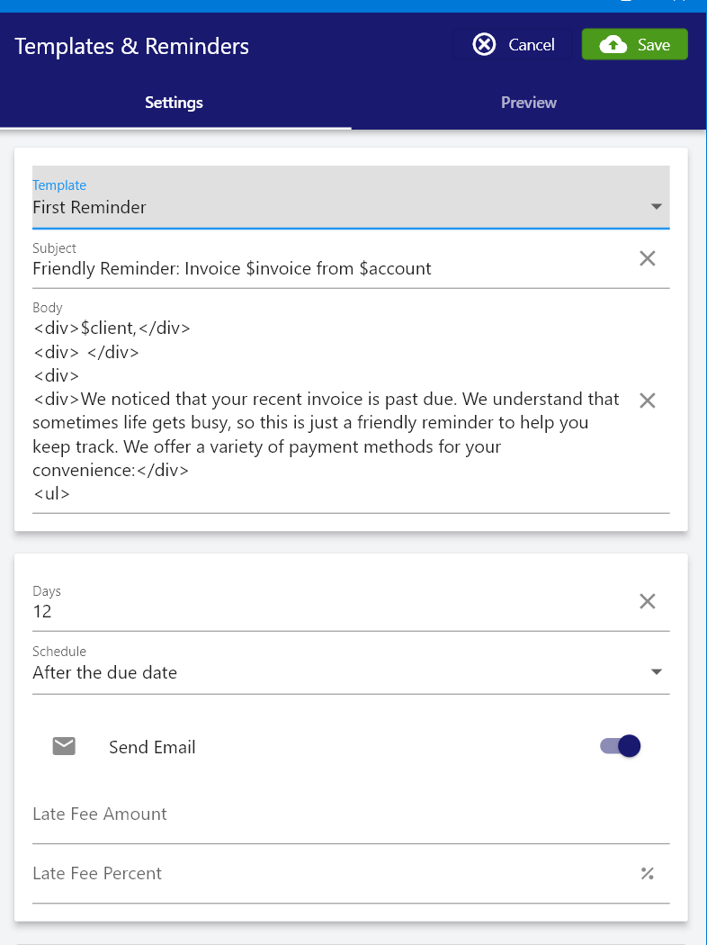

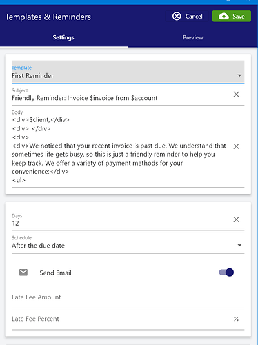

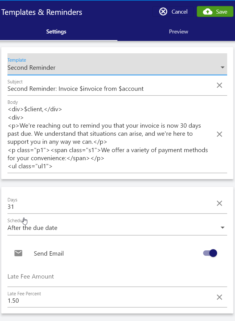

App configuration:

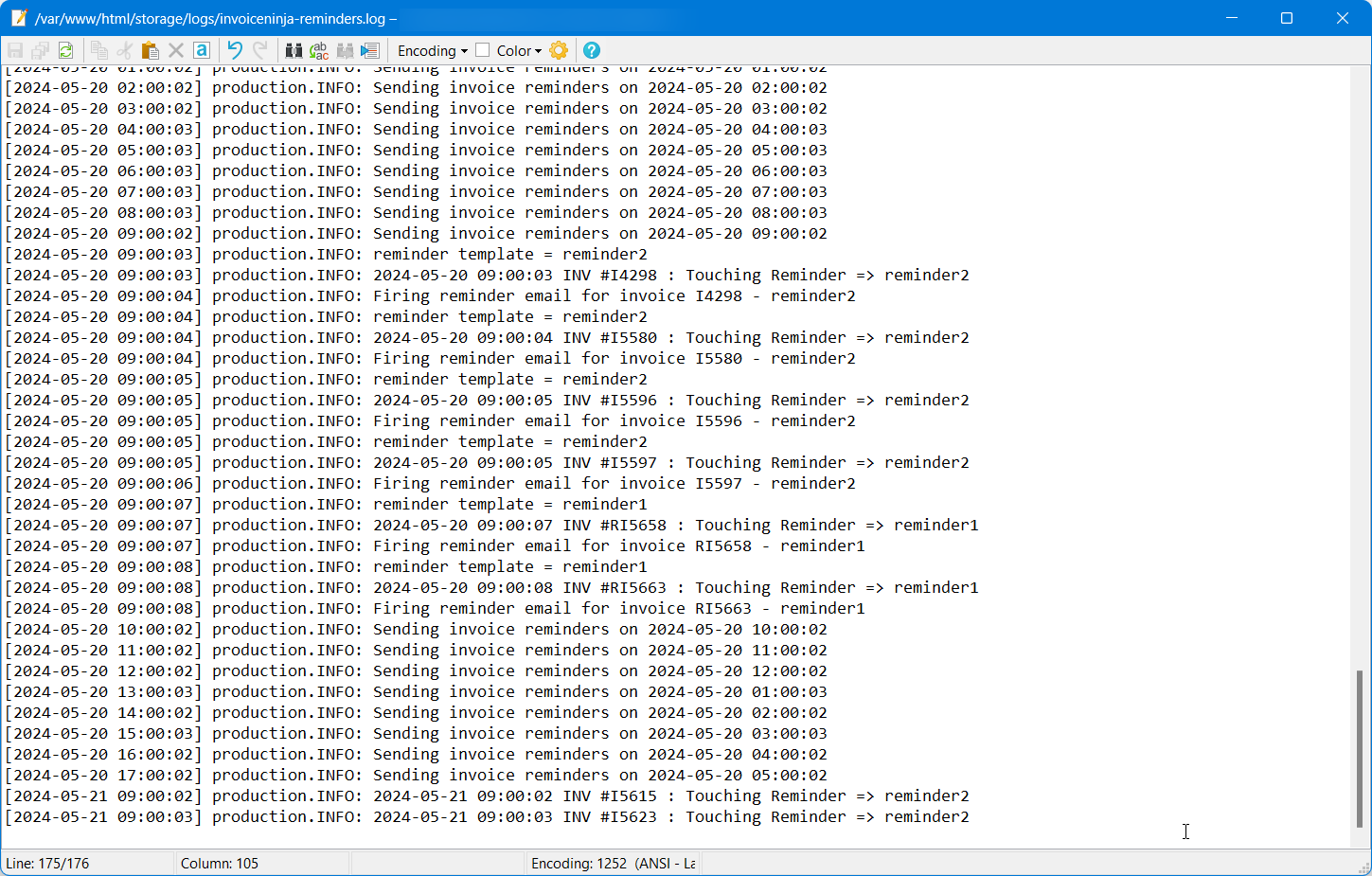

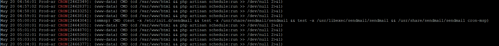

Cron job log:

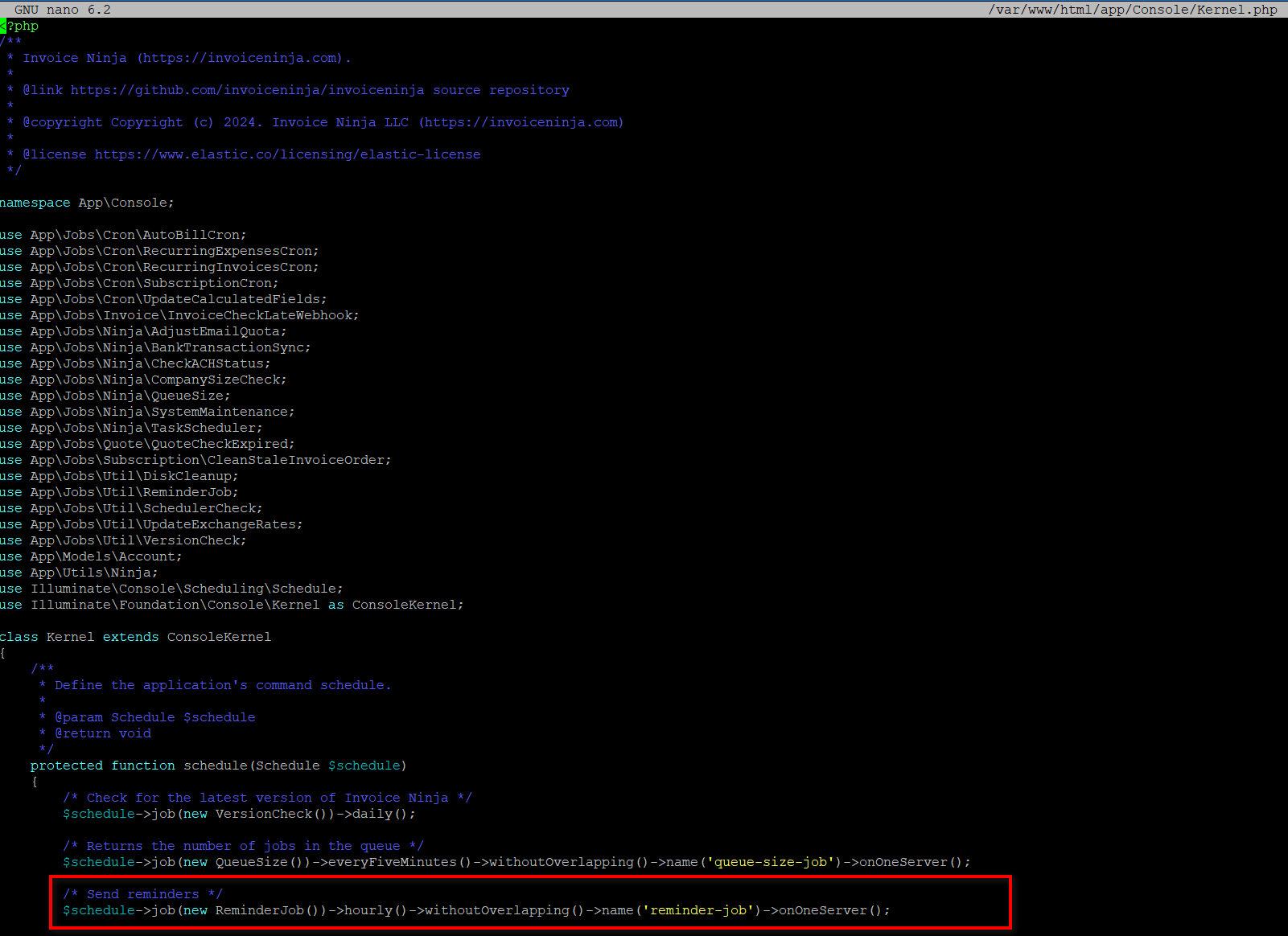

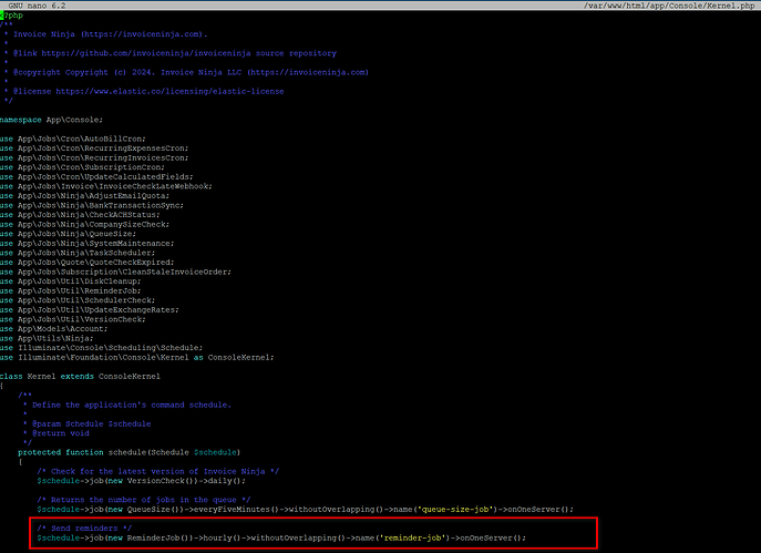

Cron Schedule:

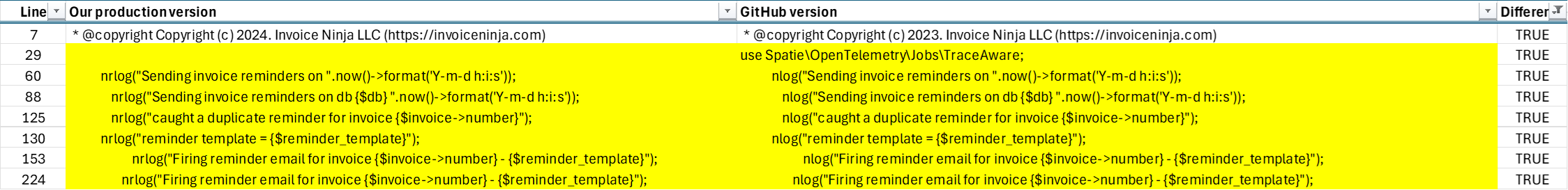

I compared the code in our app vs the code on Github v5 stable for two php files:
File 1) ReminderJob.php: I noted differences as it relates to logging, but I’m not sure that would have caused this.
File 2) SendRemindersCron.php, no differences.
compared Github versions:

/v5-stable/app/Console/Commands/SendRemindersCron.php

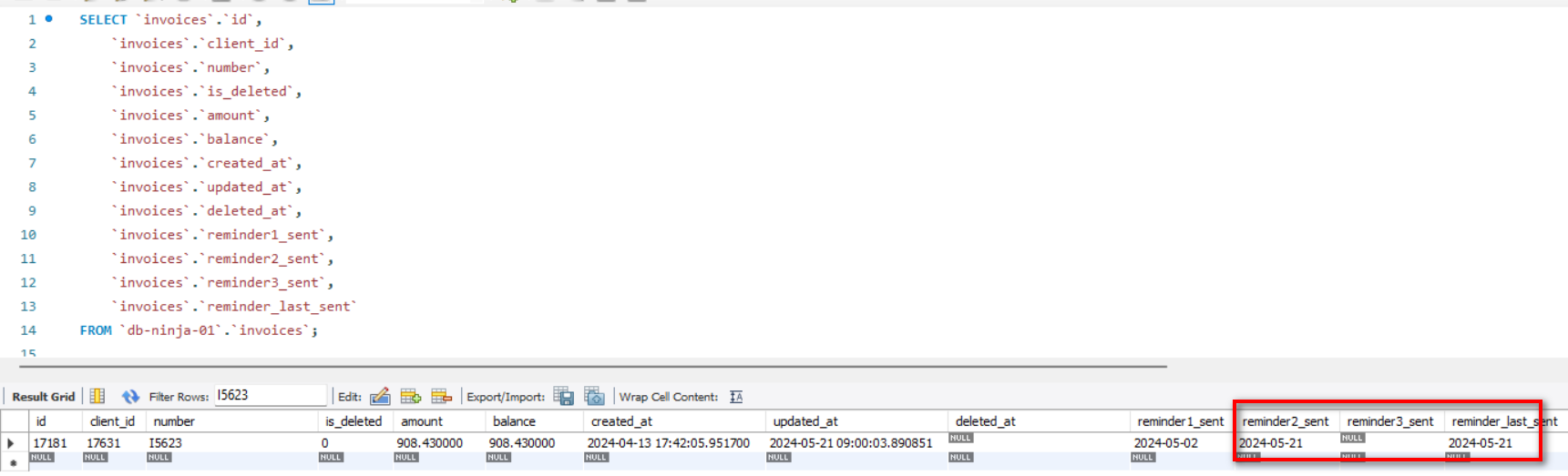

@david - the system is also writing to the table that a reminder was sent this morning (May 21), but really wasn’t sent. I’m not sure if that’s by design. Log file I pulled this morning. I turned the reminders off yesterday, so for today (May 21) there is no entry for Firing reminder email:
mySQL db:
@hillel thanks.
“touching” a reminder is different to sending a reminder, it updates the column in the db but does not send.
