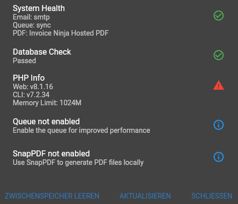

hi, could it be that the PHP Version missmatch is the reason?
PHP Version from SSH Terminal
PHP Version (CLI) from InvoiceNinja Systemcheck
hillel
July 17, 2023, 7:25am
30
That could very likely explain the problem.

yes but just in the command line invoiceninja System Check show an older version
Command Line php -v
InvoiceNinja System Check
hillel
July 27, 2023, 8:00am
36
@david any ideas why the PHP version is different?

okay if ckeck the version via ssh with php it shows me the version 8.1.xx but if i check the Version with php script in the browser with exec it shows me the version 7.2.xx…
I think i open a ticket at me provider and ask him why?

We just scrape whatever the CLI outputs for php -V
On shared hosting, it is always hit and miss, and i’m unsure of the accuracy of it in some scenarios.
sven.j
July 27, 2023, 9:08am
40
yes i`ve tryed the same with php exec for php-v and the Version is 7.2.34 i wait for the naxt Version and hope it fixed this issue and i have opend a ticket at my provider for another solution to bring the PHP Version of the same level
