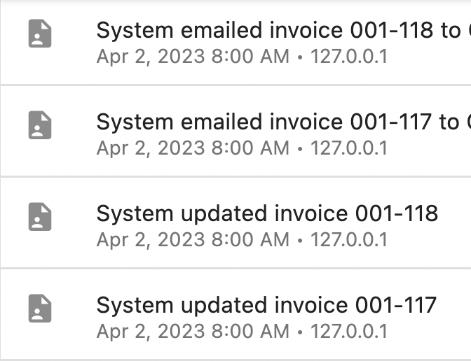

Recently my recurring invoices have started to send two of the same invoice out. My crons are as below:

Why are you running the console command for recurring invoices and send reminders in your cron?
The recurring invoices should only be run by the schedule:run command
The first two should be removed.
That is what the initial guide I used said was required. I have removed the top two lines and only have the schedule:run line enabled, and will report back. Thank you.
