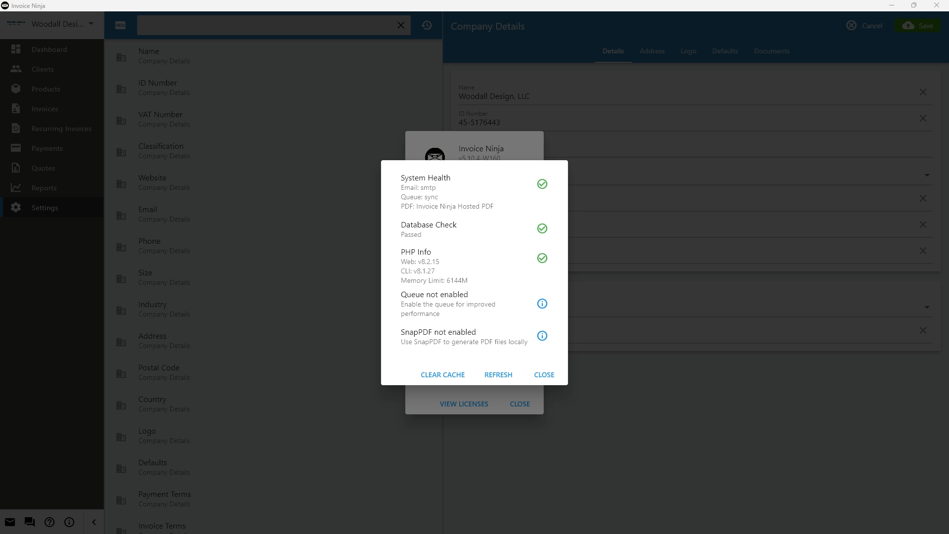

Is the queue enabled/are there records in the jobs table?
Where would I check these?
Can you post a screenshot of the health check dialog
I see what you mean. But these had to have been working as I’ve been using this for ages.

But what about the two items that failed on the health check? Do I need to worry about them?
Those are suggested improvements, not failures. They can be ignored.
