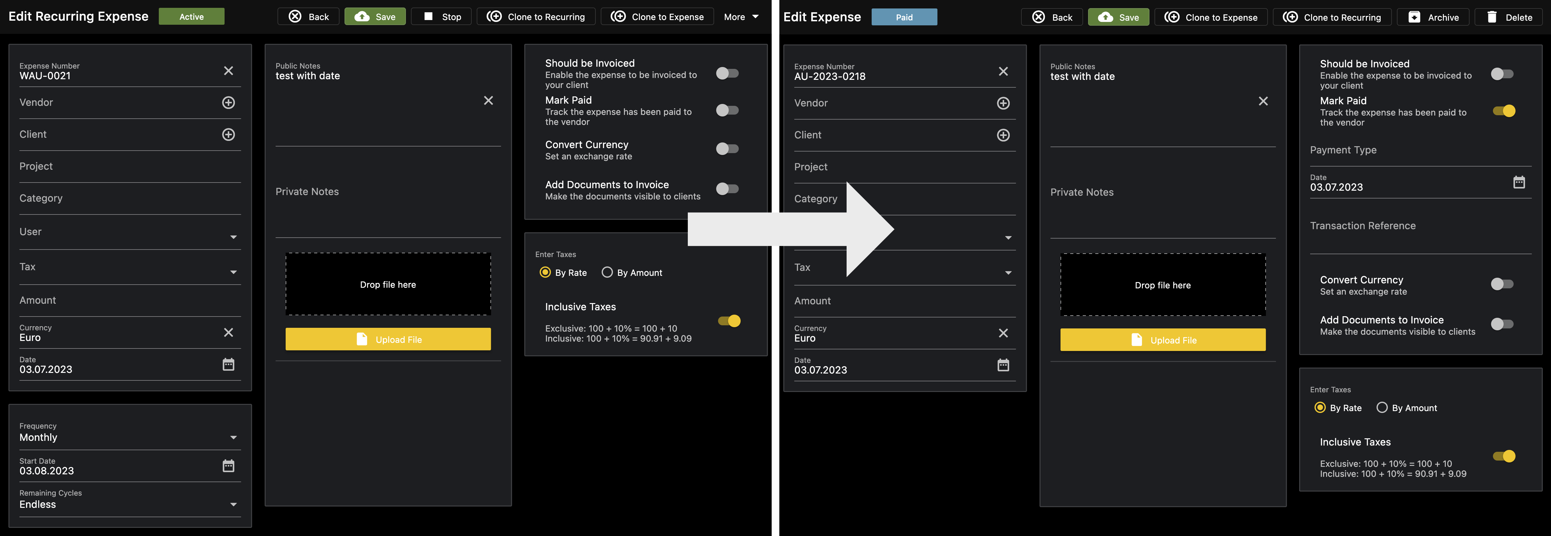

I created two recurring expenses for testing purposes. One with a date, the other one without. None of them is marked as paid, but the resulting expenses are marked as paid.
Recurring expense with date
Recurring expense without date
Can you check if mark paid is enabled on Settings > Expense Settings, it may be causing the issue.
Thanks for the suggestion, but this field is not enabled.

I found an issue (bug-report is created)!
When one set ups a payment-type and switches the (recurring) expense to off again, the expense will be marked as paid, no matter if it’s set to or not. Try it with the demo.
And that’s a not so nice behavoure, because for recurring expenses I set up the payment-type to save clicks when I edit it for putting payment-date, invoice-number and other details in. So one may miss to edit one expense because of the false mark.
