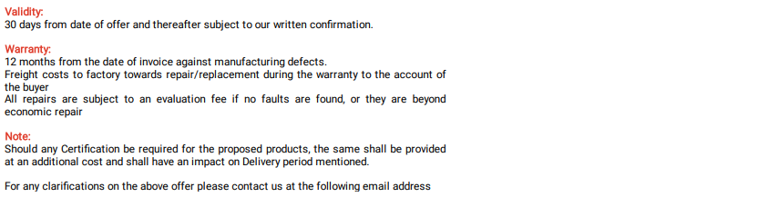

In the attached image, there is a lot of space available on the page where i am displaying these conditions but for some reason, the text does not use the who space available in each line and ends up moving the text to the next line.

The terms shares a section next to the totals, so it is restricted to about 2/3’s of the pages width.

So now, I managed to start it on the next page, but it feels weird as to why this width is 2/3rd when i am on a new page. I can understand if this is applicable on the same page as the quote with the line items and totals.
Would it be possible to make it use the full width if Terms and Conditions are started on a new page??

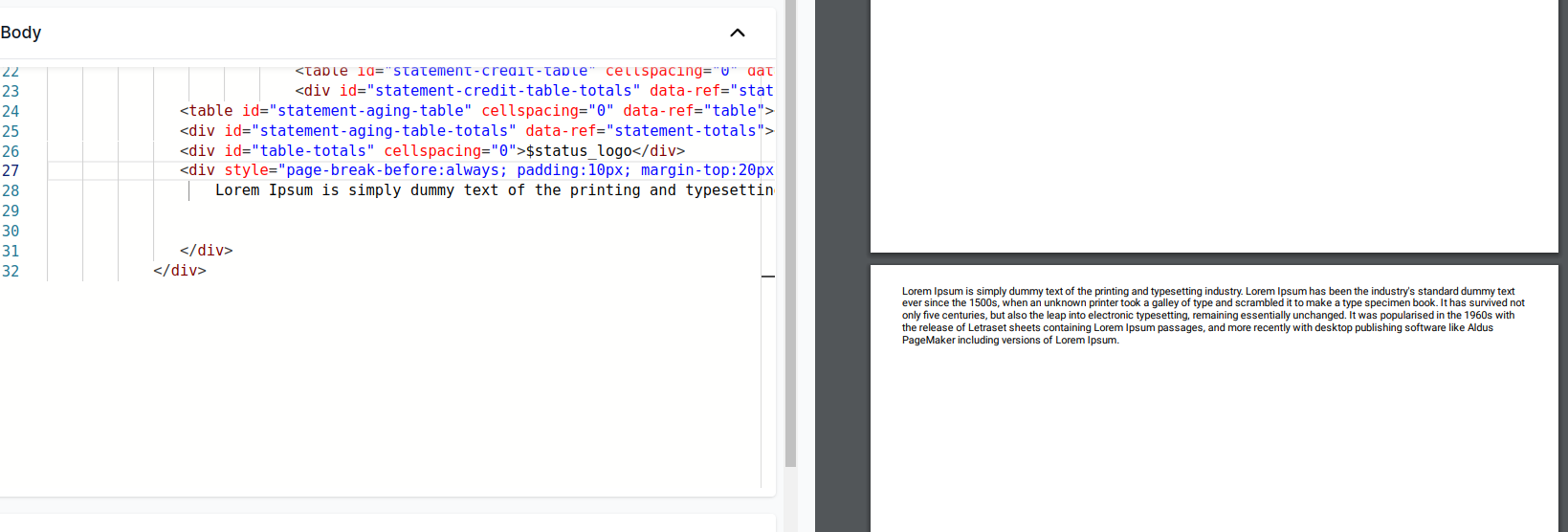

Hi @david, Could you try writing a line of text which goes till the end of the line in the second page? It tends to wrap the text right before the point where the Balance Due text starts on the next page.
If you can share how this is done to prevent the wrap text on page 2, that would solve my issue.
I am just getting started with Invoice Ninja and will now look into the custom design feature.
The new div will be full width.

Thanks for the video and snapshot of the code.

If you follow the video above, that is all that is required when creating a new design.
Afterwards, just ensure your default quote terms are set in Settings > Company Details > Defaults and these will be used in each Quote.
