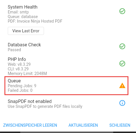

Describe the bug
In the Queue are pending jobs and they have to be flushed manually with the following console command:
php artisan queue:work database --queue=scout
Expected Behavior
A fix to prevent pending jobs
Screenshots
Is there a fix to have no pending jobs in Queue?

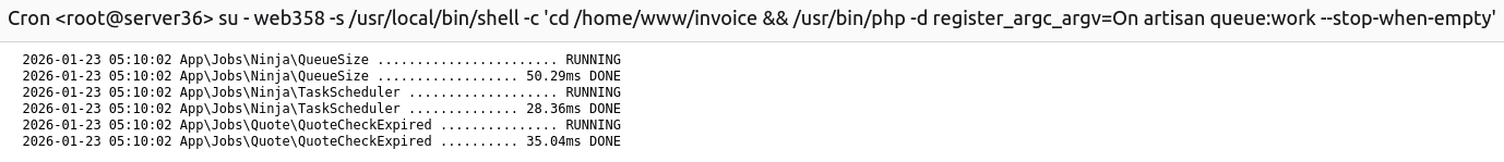

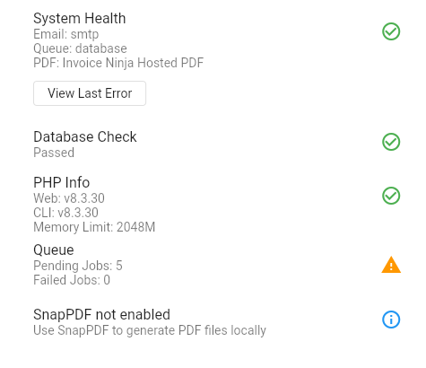

Hi! :slight_smile:
I use a cronjob with following command:
cd /home/www/invoice && /usr/bin/php -d register_argc_argv=On artisan queue:work --stop-when-empty
I receive a e-mail, when the job is finished, with this details:

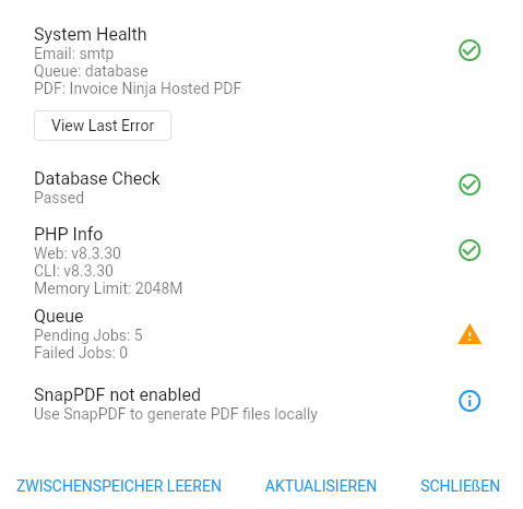

But still 5 jobs are pending:
It’s a shared hosting.
Am I mistaken in thinking that it won’t work?
Or can you give me a hint as to how to solve this?
Are you able to test the cron from the command line?
Yes, you can see it here.
But after finishing this job, the queue is still pending:
