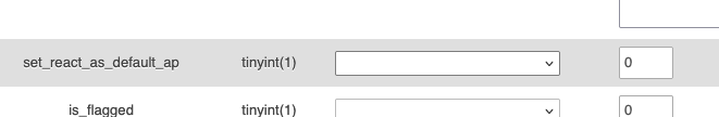

  4. Entered “UPDATE accounts SET set_react_as_default_ap = 0;” in the window
  5. Clicked “Simulate query” to check
  6. Received the message
SQL query:
Matched rows: [0]
However, I did find it in the database and it’s set to 0.
Did I miss something?
