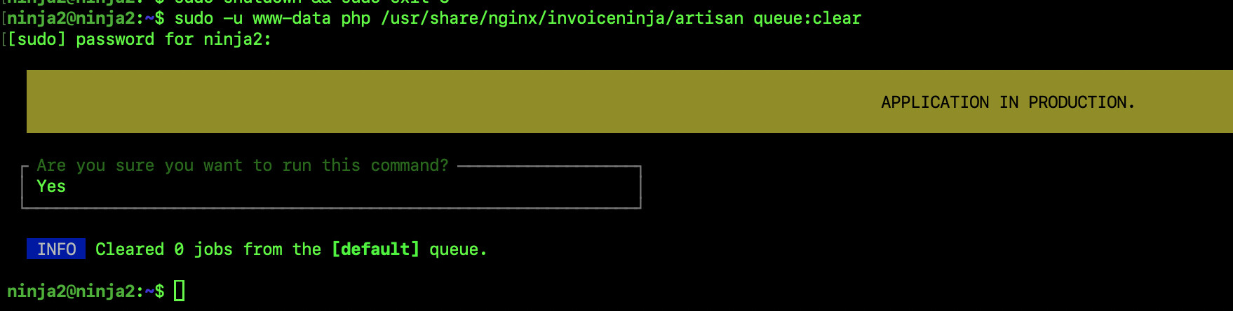

I believe you can use queue:clear to clear pending jobs.
That did not clear it.
