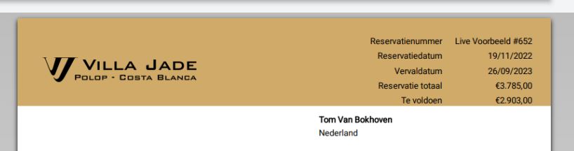

On my invoice i set the due date to 26/09/2023.
On the preview below it’s correct.
When i view pdf it’s the wrong date.

The issue here is the PDF is not regenerating after updating.
Are you using
QUEUE_CONNECTION=sync
or
QUEUE_CONNECTION=database
I have a feeling your queue’s may not actually be running?

I don’t think your queue is running.
Can you try changing QUEUE_CONNECTION=sync
and then update the cache /update?secret=secret or php artisan optimize

It sounds like your queue is not running so the PDFs are not regenerating after the update.
You can try changing QUEUE_CONNECTION=sync which should resolve the issue, but slow down the interface a little bit.
