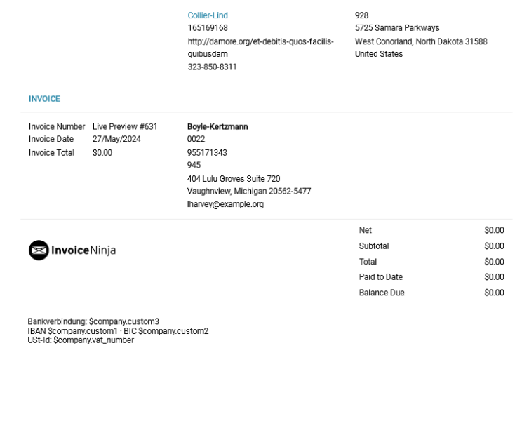

Hello,
I have this description in the standards of the invoice footer.
Bankverbindung: $company.custom3
IBAN $company.custom1 · BIC $company.custom2
USt-Id: $company.vat_number</p>
Unfortunately, this is ignored when generating the invoice PDFs.
Is this intentional or an error?
Does changing the design make a difference?
Also, can you reproduce the problem in either of the demos?

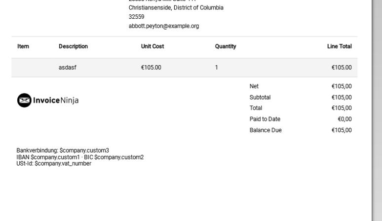

Fast check on Flutter-Demo in Preview:
On Send-Preview:
This is not my Design
It looks like custom variables are support in the invoice terms but not the footer.
Feel free to create an issue on GitHub to request that support is added.
As a workaround you should be able to create a custom design which hard codes the custom footer.
