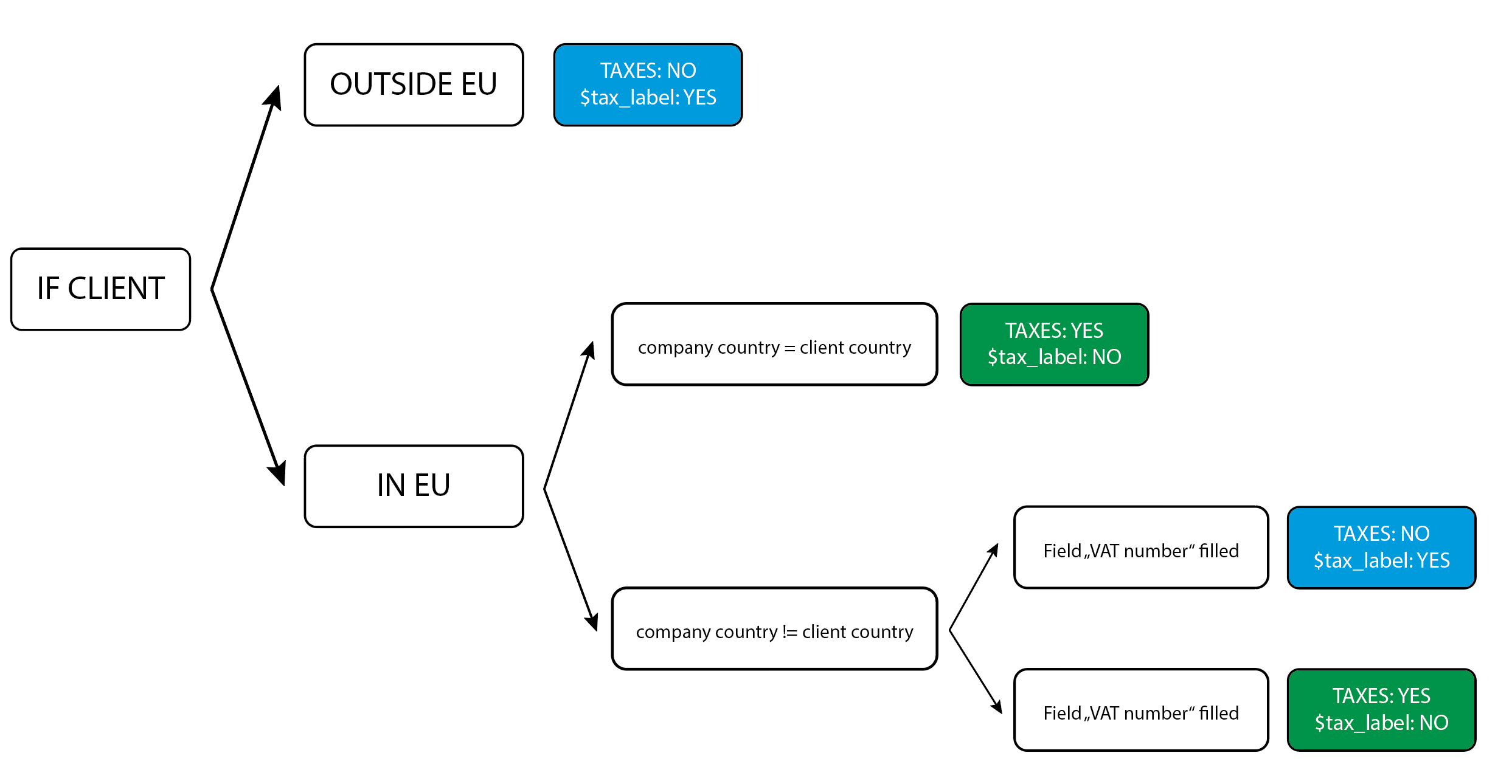

Hello @david,
Oh, so this is not a perfect logic. The problem i now have is exactly because of the missing logic.
In the last if you have also to check if the field “VAT number” is also filled out. If so - the invoice can be without tax.
So in short:
If company country = client country: Display tax and do not display $tax_label
If company country != client country (client is in EU): Display tax and do not display $tax_label
If company country != client country (client is in EU) AND field “VAT number” is filled: Display no taxes on invoice and display $tax_label
This should be correct, but when automatic tax calculation is active i can not choose that when client is in the EU i think?
For my undertanding the correct way will be to check if the VAT number field is filled. Because then i am allowed to create a VAT free invoice (both VAT numbers have to be on invoice visible).
EDIT:
Can you tell me where i can see which text ist standard behind:
intracommunity_tax_info
triangular_tax_info
reverse_tax_info
(i can not see that on Invoice Ninja localization | Transifex without joining / creating account)
Regards, Andreas
Couple of issues with the suggested logic
Not necessarily, they could be outside EU also
Does every entity in EU (personal / business) have a vat number? I would have thought that personal clients, may not be vat registered at all?
Yes, I didn’t take that into account before. There also should be a if-clause for that.
No, just businesses can have a VAT number. But the point here is that they CAN have a VAT number. They may have one or have not. If not - then the invoice can not be tax free and it can not have the $tax_label on it.
So we need to build the rule for companies in EU like that i think?
The $tax_label text itself should be different. It can be also different when in EU and VAT number is filled. Because the legal text for a intracommunity delivery is different to intracommunity service.
