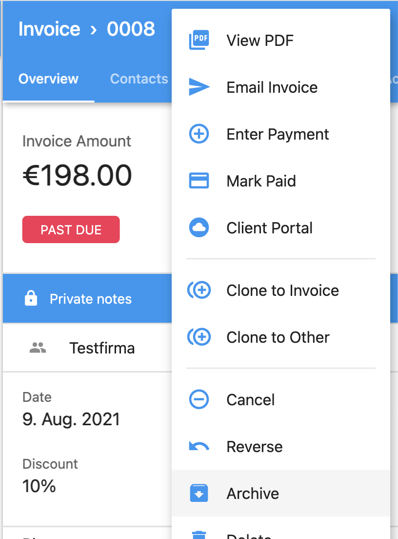

An ideal solution would also offer an option to link the credit note to the original invoice. For example by adding an additional option here:
But that is just a bonus.

Eventually the other way around makes it a bit easier. Instead of creating a negative payment from the invoice, we could create a credit note from the invoice. So it is still linked to the invoice, item positions can be set/change and after the credit note is saved, a (negative) payment can be made from the credit note.
