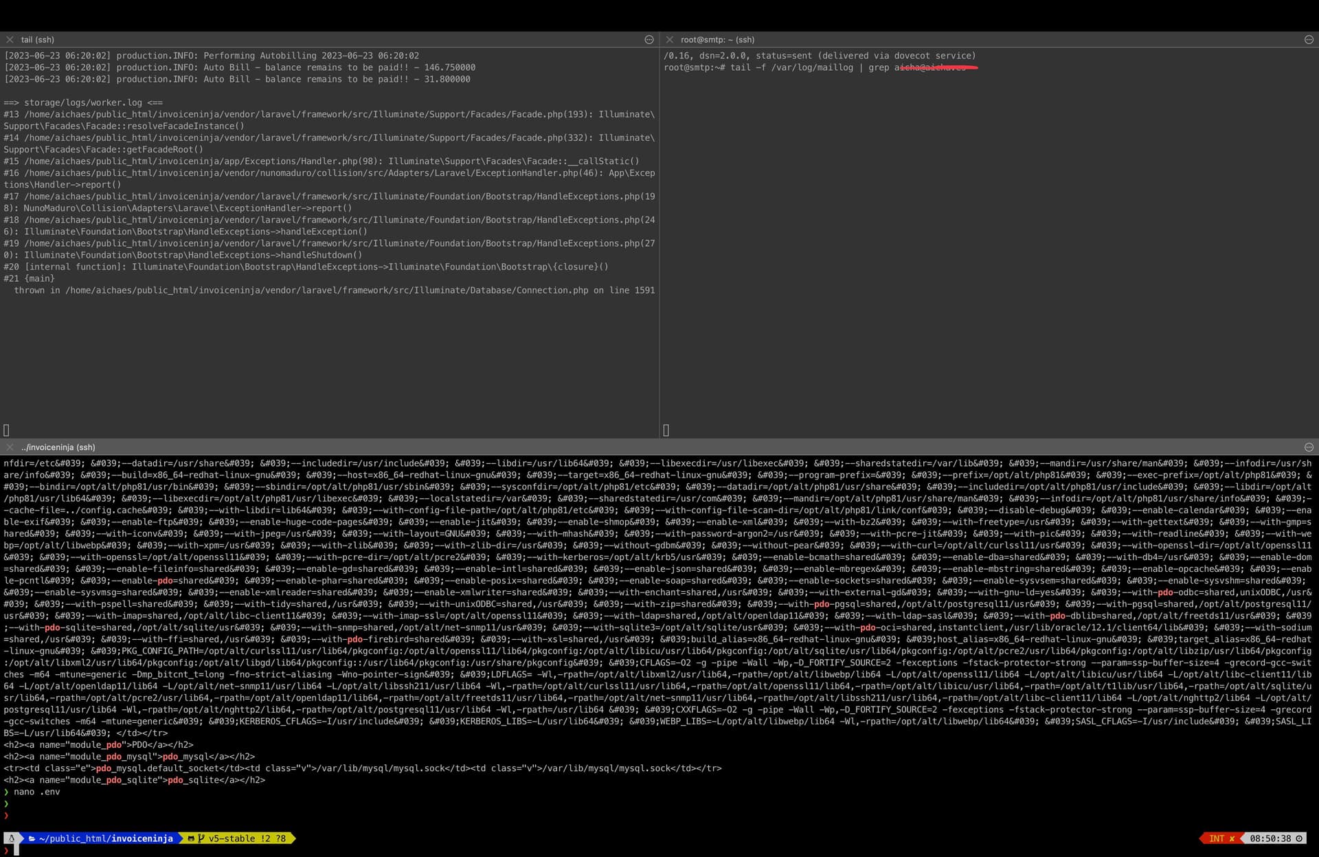

php cli on shell
This php info show that PDO is installed on shell for the user.
 /usr/bin/php -i | grep pdo
<tr><td class="e">Configure Command </td><td class="v"> &#039;./configure&#039;  &#039;--disable-dependency-tracking&#039; &#039;--prefix=/usr&#039; &#039;--exec-prefix=/usr&#039; &#039;--bindir=/usr/bin&#039; &#039;--sbindir=/usr/sbin&#039; &#039;--sysconfdir=/etc&#039; &#039;--datadir=/usr/share&#039; &#039;--includedir=/usr/include&#039; &#039;--libdir=/usr/lib64&#039; &#039;--libexecdir=/usr/libexec&#039; &#039;--sharedstatedir=/var/lib&#039; &#039;--mandir=/usr/share/man&#039; &#039;--infodir=/usr/share/info&#039; &#039;--build=x86_64-redhat-linux-gnu&#039; &#039;--host=x86_64-redhat-linux-gnu&#039; &#039;--target=x86_64-redhat-linux-gnu&#039; &#039;--program-prefix=&#039; &#039;--prefix=/opt/alt/php81&#039; &#039;--exec-prefix=/opt/alt/php81&#039; &#039;--bindir=/opt/alt/php81/usr/bin&#039; &#039;--sbindir=/opt/alt/php81/usr/sbin&#039; &#039;--sysconfdir=/opt/alt/php81/etc&#039; &#039;--datadir=/opt/alt/php81/usr/share&#039; &#039;--includedir=/opt/alt/php81/usr/include&#039; &#039;--libdir=/opt/alt/php81/usr/lib64&#039; &#039;--libexecdir=/opt/alt/php81/usr/libexec&#039; &#039;--localstatedir=/var&#039; &#039;--sharedstatedir=/usr/com&#039; &#039;--mandir=/opt/alt/php81/usr/share/man&#039; &#039;--infodir=/opt/alt/php81/usr/share/info&#039; &#039;--cache-file=../config.cache&#039; &#039;--with-libdir=lib64&#039; &#039;--with-config-file-path=/opt/alt/php81/etc&#039; &#039;--with-config-file-scan-dir=/opt/alt/php81/link/conf&#039; &#039;--disable-debug&#039; &#039;--enable-calendar&#039; &#039;--enable-exif&#039; &#039;--enable-ftp&#039; &#039;--enable-huge-code-pages&#039; &#039;--enable-jit&#039; &#039;--enable-shmop&#039; &#039;--enable-xml&#039; &#039;--with-bz2&#039; &#039;--with-freetype=/usr&#039; &#039;--with-gettext&#039; &#039;--with-gmp=shared&#039; &#039;--with-iconv&#039; &#039;--with-jpeg=/usr&#039; &#039;--with-layout=GNU&#039; &#039;--with-mhash&#039; &#039;--with-password-argon2=/usr&#039; &#039;--with-pcre-jit&#039; &#039;--with-pic&#039; &#039;--with-readline&#039; &#039;--with-webp=/opt/alt/libwebp&#039; &#039;--with-xpm=/usr&#039; &#039;--with-zlib&#039; &#039;--with-zlib-dir=/usr&#039; &#039;--without-gdbm&#039; &#039;--without-pear&#039; &#039;--with-curl=/opt/alt/curlssl11/usr&#039; &#039;--with-openssl-dir=/opt/alt/openssl11&#039; &#039;--with-openssl=/opt/alt/openssl11&#039; &#039;--with-pcre-dir=/opt/alt/pcre2&#039; &#039;--with-kerberos=/opt/alt/krb5/usr&#039; &#039;--enable-bcmath=shared&#039; &#039;--enable-dba=shared&#039; &#039;--with-db4=/usr&#039; &#039;--enable-dom=shared&#039; &#039;--enable-fileinfo=shared&#039; &#039;--enable-gd=shared&#039; &#039;--enable-intl=shared&#039; &#039;--enable-json=shared&#039; &#039;--enable-mbregex&#039; &#039;--enable-mbstring=shared&#039; &#039;--enable-opcache&#039; &#039;--enable-pcntl&#039; &#039;--enable-pdo=shared&#039; &#039;--enable-phar=shared&#039; &#039;--enable-posix=shared&#039; &#039;--enable-soap=shared&#039; &#039;--enable-sockets=shared&#039; &#039;--enable-sysvsem=shared&#039; &#039;--enable-sysvshm=shared&#039; &#039;--enable-sysvmsg=shared&#039; &#039;--enable-xmlreader=shared&#039; &#039;--enable-xmlwriter=shared&#039; &#039;--with-enchant=shared,/usr&#039; &#039;--with-external-gd&#039; &#039;--with-gnu-ld=yes&#039; &#039;--with-pdo-odbc=shared,unixODBC,/usr&#039; &#039;--with-pspell=shared&#039; &#039;--with-tidy=shared,/usr&#039; &#039;--with-unixODBC=shared,/usr&#039; &#039;--with-zip=shared&#039; &#039;--with-pdo-pgsql=shared,/opt/alt/postgresql11/usr&#039; &#039;--with-pgsql=shared,/opt/alt/postgresql11/usr&#039; &#039;--with-imap=shared,/opt/alt/libc-client11&#039; &#039;--with-imap-ssl=/opt/alt/openssl11&#039; &#039;--with-ldap=shared,/opt/alt/openldap11&#039; &#039;--with-ldap-sasl&#039; &#039;--with-pdo-dblib=shared,/opt/alt/freetds11/usr&#039; &#039;--with-pdo-sqlite=shared,/opt/alt/sqlite/usr&#039; &#039;--with-snmp=shared,/opt/alt/net-snmp11/usr&#039; &#039;--with-sqlite3=/opt/alt/sqlite/usr&#039; &#039;--with-pdo-oci=shared,instantclient,/usr/lib/oracle/12.1/client64/lib&#039; &#039;--with-sodium=shared,/usr&#039; &#039;--with-ffi=shared,/usr&#039; &#039;--with-pdo-firebird=shared&#039; &#039;--with-xsl=shared,/usr&#039; &#039;build_alias=x86_64-redhat-linux-gnu&#039; &#039;host_alias=x86_64-redhat-linux-gnu&#039; &#039;target_alias=x86_64-redhat-linux-gnu&#039; &#039;PKG_CONFIG_PATH=/opt/alt/curlssl11/usr/lib64/pkgconfig:/opt/alt/openssl11/lib64/pkgconfig:/opt/alt/libicu/usr/lib64/pkgconfig:/opt/alt/sqlite/usr/lib64/pkgconfig:/opt/alt/pcre2/usr/lib64/pkgconfig:/opt/alt/libzip/usr/lib64/pkgconfig:/opt/alt/libxml2/usr/lib64/pkgconfig:/opt/alt/libgd/lib64/pkgconfig::/usr/lib64/pkgconfig:/usr/share/pkgconfig&#039; &#039;CFLAGS=-O2 -g -pipe -Wall -Wp,-D_FORTIFY_SOURCE=2 -fexceptions -fstack-protector-strong --param=ssp-buffer-size=4 -grecord-gcc-switches -m64 -mtune=generic -Dmp_bitcnt_t=long -fno-strict-aliasing -Wno-pointer-sign&#039; &#039;LDFLAGS= -Wl,-rpath=/opt/alt/libxml2/usr/lib64,-rpath=/opt/alt/libwebp/lib64 -L/opt/alt/openssl11/lib64 -L/opt/alt/libicu/usr/lib64 -L/opt/alt/libc-client11/lib64 -L/opt/alt/openldap11/lib64 -L/opt/alt/net-snmp11/usr/lib64 -L/opt/alt/libssh211/usr/lib64 -Wl,-rpath=/opt/alt/curlssl11/usr/lib64,-rpath=/opt/alt/openssl11/lib64,-rpath=/opt/alt/libicu/usr/lib64,-rpath=/opt/alt/t1lib/usr/lib64,-rpath=/opt/alt/sqlite/usr/lib64,-rpath=/opt/alt/pcre2/usr/lib64,-rpath=/opt/alt/openldap11/lib64,-rpath=/opt/alt/freetds11/usr/lib64,-rpath=/opt/alt/net-snmp11/usr/lib64,-rpath=/opt/alt/libssh211/usr/lib64,-rpath=/opt/alt/libc-client11/lib64 -L/opt/alt/nghttp2/lib64 -L/opt/alt/postgresql11/usr/lib64 -Wl,-rpath=/opt/alt/nghttp2/lib64,-rpath=/opt/alt/postgresql11/usr/lib64 -Wl,-rpath=/usr/lib64 &#039; &#039;CXXFLAGS=-O2 -g -pipe -Wall -Wp,-D_FORTIFY_SOURCE=2 -fexceptions -fstack-protector-strong --param=ssp-buffer-size=4 -grecord-gcc-switches -m64 -mtune=generic&#039; &#039;KERBEROS_CFLAGS=-I/usr/include&#039; &#039;KERBEROS_LIBS=-L/usr/lib64&#039; &#039;WEBP_LIBS=-L/opt/alt/libwebp/lib64 -Wl,-rpath=/opt/alt/libwebp/lib64&#039; &#039;SASL_CFLAGS=-I/usr/include&#039; &#039;SASL_LIBS=-L/usr/lib64&#039; </td></tr>
<h2><a name="module_pdo">PDO</a></h2>
<h2><a name="module_pdo_mysql">pdo_mysql</a></h2>
<tr><td class="e">pdo_mysql.default_socket</td><td class="v">/var/lib/mysql/mysql.sock</td><td class="v">/var/lib/mysql/mysql.sock</td></tr>
<h2><a name="module_pdo_sqlite">pdo_sqlite</a></h2>

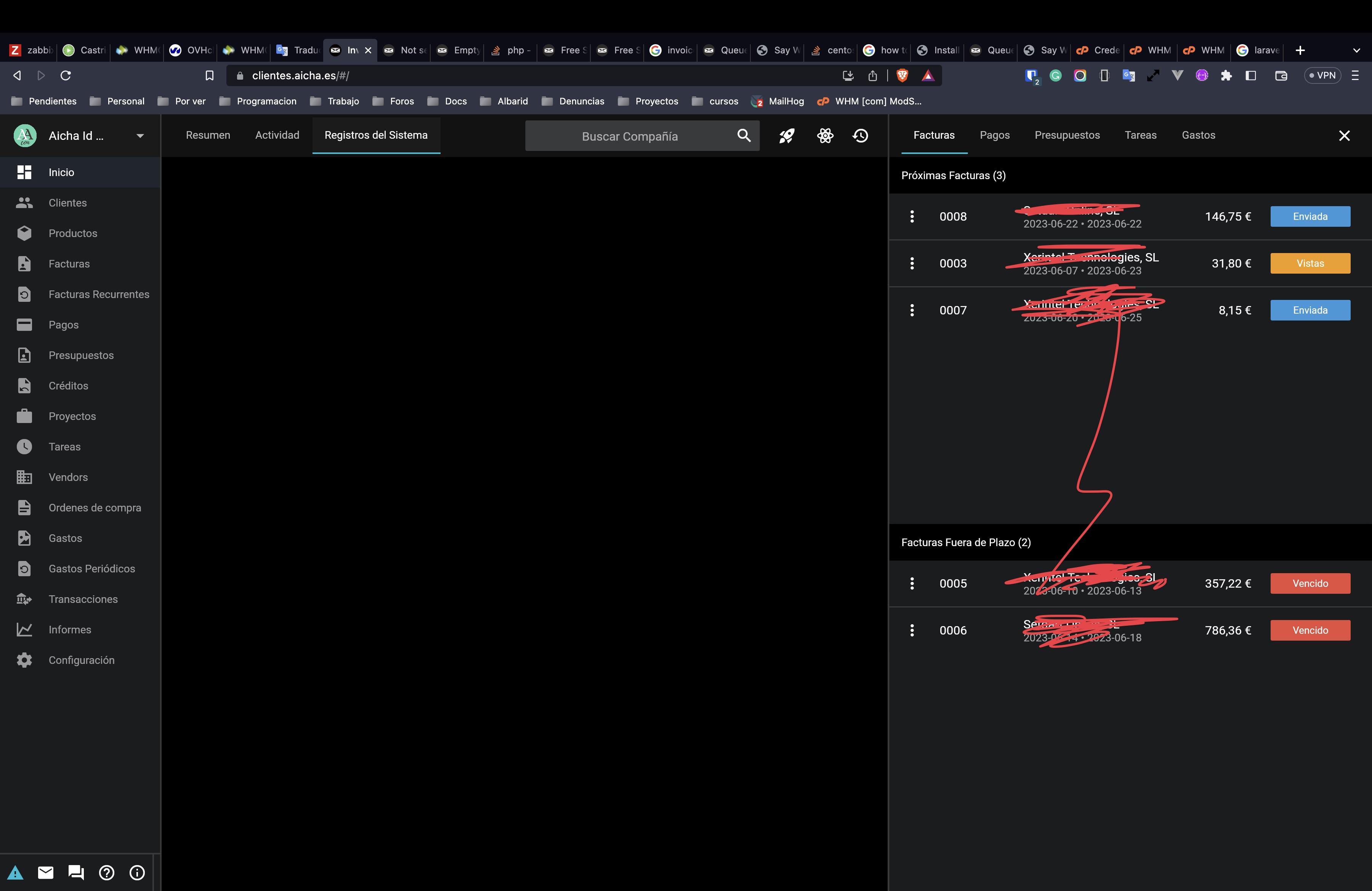

Well, we still don’t get any errors, neither in the dashboard nor in the Laravel log.
And of course we still do not send emails.
And of course we still don’t see any error, while the interface after 30 seconds tells us “Budget sent correctly”
On my screen three shells with their respective logs involved.
And of course, the dashbaord log system says 0.
In this state of affairs, it is quite difficult to find a fault in an application, its configuration.
