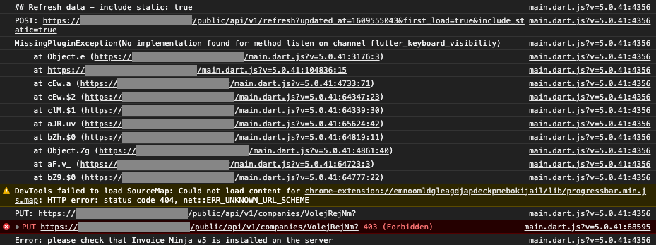

can you paste a screenshot of the exact error in the console please?
For sure !
This is console errors when saving changes of company details :
And this is error when pign the api :

@hillel have resolve my problem !
https://forum2.invoiceninja.com/t/cant-pay-invoice-frobidden/5612/2?u=k-meleon
I desactivate Modsec on the v5 app and v4. Now its perfectly works ! Yhea !
