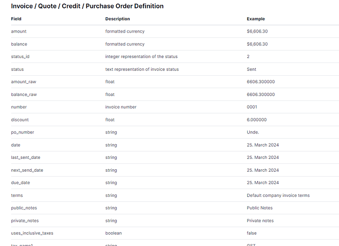

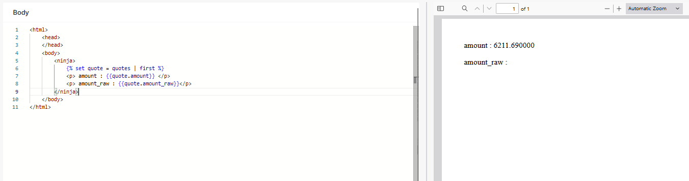

Hi, when I design custom invoice templates, i get the variables amount_raw, total_tax_map etc… However those are missing whenever I design custom quote templates. In the docs for templates, it is said that they are available.
Maybe this will help:
How are you accessing the variable?
@david can you please advise?
For quotes you’ll want to use balance_raw, In the mean time I’ll also add amount_raw
