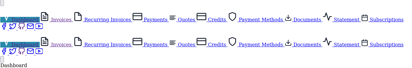

BUT…the user portal looks like this:
Getting closer.
I need to get this right before I remove the v4 and replace with v5 on the REAL server.

Also the user portal still doesn’t display correctly as stated previously. Any ideas regarding that one?
Thanks for tracking down the source of the problem, I’ve shared the info with the relevant developer.
For the portal issue, do you see any failed requests in the network tab of the browser console?

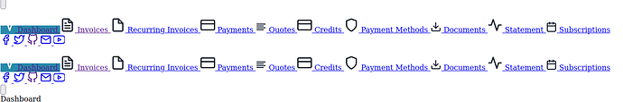

No I see nothing just shows up like on the screen shot earlier I posted.
I just tried the flatpak app and it doesn’t work either. I may be haproxy that I am using. Will investigate later. Have to go out now.

I then tested the user portal and that worked as well.
CONCLUSION:
The language issue seems to be if the v4 language is not in v5 it doesn’t work.
The user portal issue seems to be the set up I have that forwards the webpage etc to apache. If I just use apache standard virtual host and non-docker set up it is OK.
