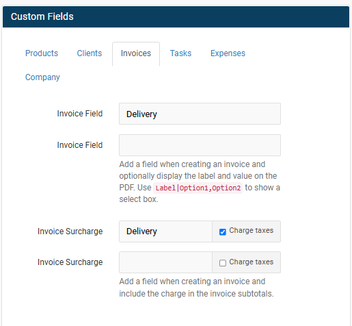

In the process of moving over to v5 finally, thought I was good tweaked all the invoices was about to hand it over to sales team then realized that all the tax calculations on Delivery from v4 is not being calculated.
If I delete the old delivery fee, save it, re-add delivery fee and save, it is taxed properly.

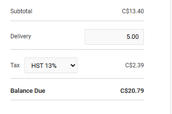

On v4:
I renamed and added an option as part of the migration

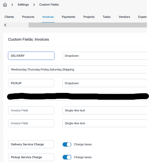

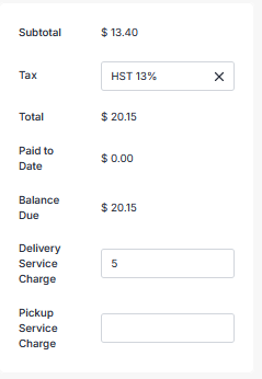

V5:
However now, when i look at all the previous invoices the Delivery fee isnt being taxed.

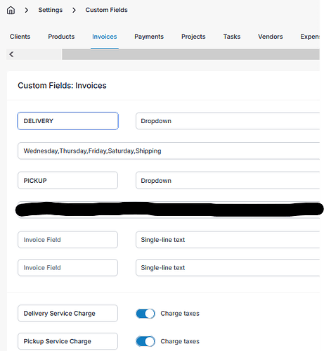

V4:
V5:

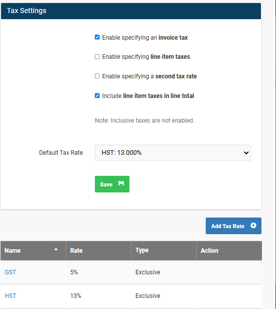

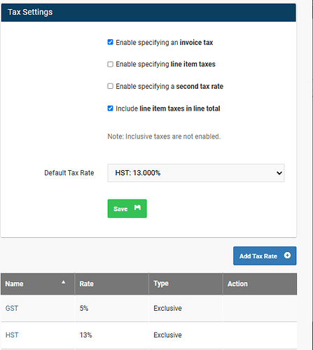

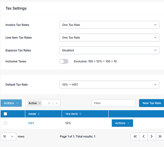

Forgot to include tax settings:
V4

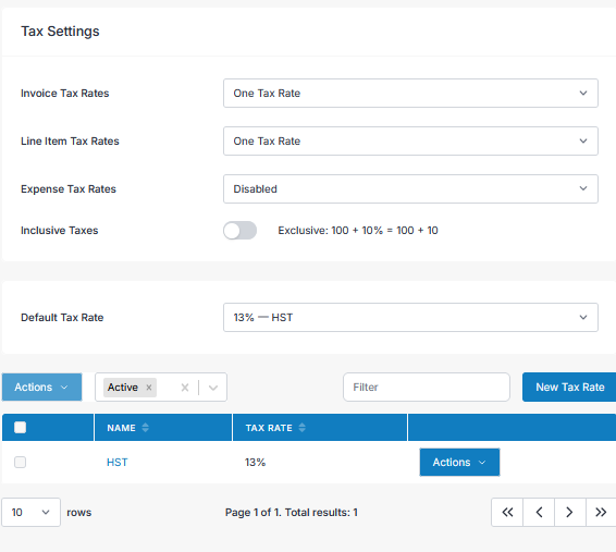

V5:
