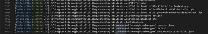

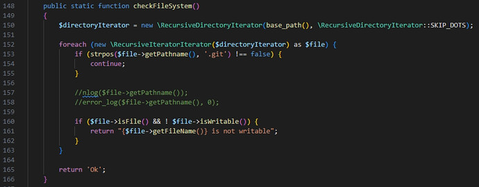

SystemHealth.php’s checkFileSystem() function tries to iterate over every file in the root directory of the website, including the vendor files, which understandably takes a while and eventually results in Maximum execution time errors.

Maybe consider not iterating over the vendor folder? My work around for now is to always return 'Ok'.

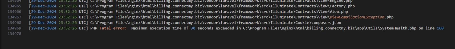

[2024-12-29 10:16:31] production.ERROR: Maximum execution time of 30 seconds exceeded {"userId":1,"exception":"[object] (Symfony\\Component\\ErrorHandler\\Error\\FatalError(code: 0): Maximum execution time of 30 seconds exceeded at C:\\Program Files\\nginx\\html\\billing.connectmy.biz\\app\\Utils\\SystemHealth.php:160)
[stacktrace]
#0 {main}
php_errors.log
[29-Dec-2024 10:16:30 UTC] PHP Fatal error: Maximum execution time of 30 seconds exceeded in C:\Program Files\nginx\html\billing.connectmy.biz\app\Utils\SystemHealth.php on line 160
