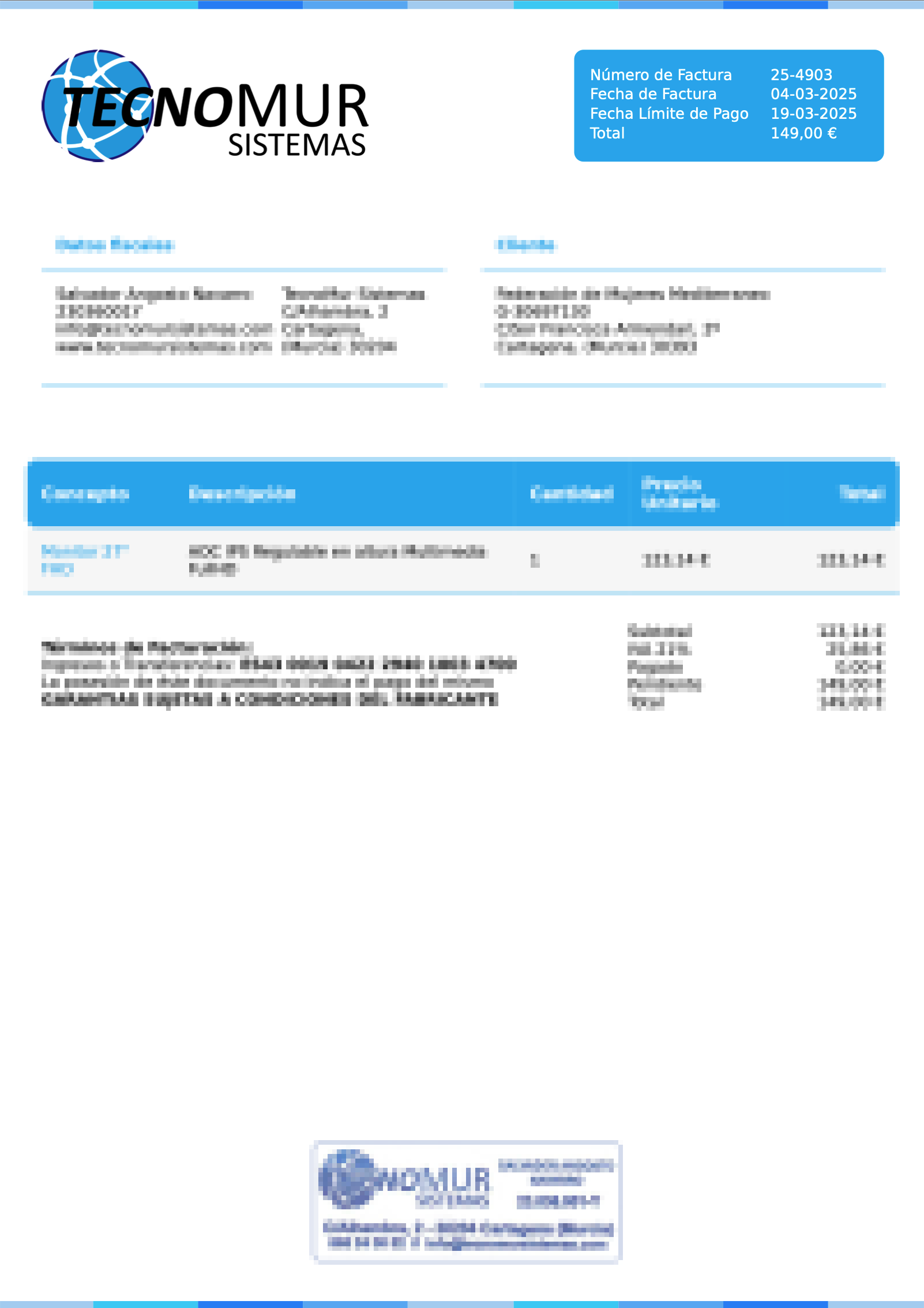

I have the following issue: I would like to place the SEPA QR code (EPC-QR-Code) on my invoice. However, when I try to adjust the height, the following happens:
Here is my code:
<div><table cellspacing="0" cellpadding="0" dir="$dir">
  <tr><td>EPC-QR-Code</td><td></td></tr>
  <tr><td colspan="3" rowspan="3"><img src="$sepa_qr_code" alt="EPC-QR-Code" height="150px"></td></tr>
</table></div>
What is my error? Has this problem been experienced by others previously?

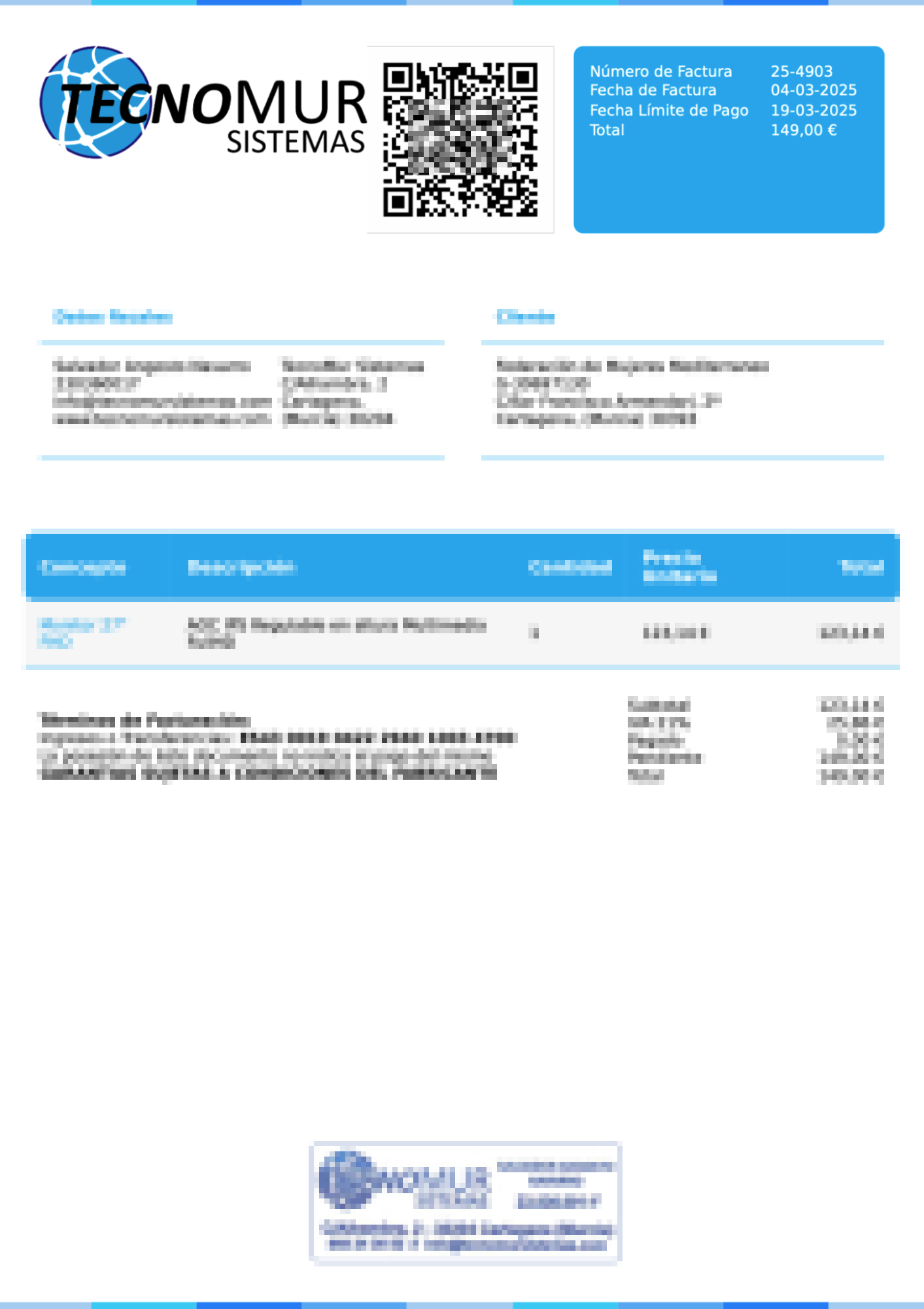

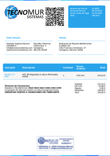

I am trying to put the qr_sepa at the top of my invoice, in the top right corner, on the left where the “entity-details” data appears. The thing is that I add it, but I don’t know how to adjust its size to fit the size of “entity-details”.
Any help is appreciated.
I read info about this, but i dont know how to do that.
P.D. I did it. There are errors in the written format.
<svg viewBox='0 0 200 200' width='100' height='100' x='0' y='0' xmlns='http://www.w3.org/2000/svg'>
          <rect x='0' y='0' width='100%' height='100%' />$sepa_qr_code_raw</svg>
