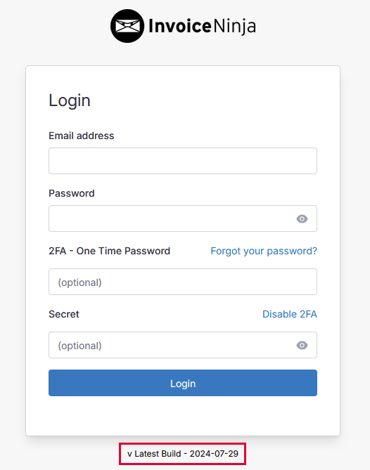

Is the "v Latest Build" still 2024-07-29 as of 5.10.24?
I’ve just upgraded from 5.10.16 to 5.10.24, and then I visited the update secret URL and emptied my /bootstrap/cache directory (as I’ve had to do after each upgrade since 5.10.x so far), and on the login screen, it still displays “v Latest Build - 2024-07-29”.
Is this expected, even though I’m running 5.10.24, released on August 14th?

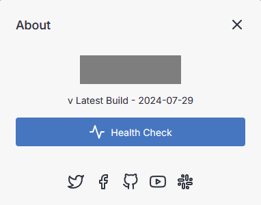

Also, the Force Update button is missing now in the Info window. Is this expected?
Just trying to figure out if the upgrade process is broken or if this is what I should be seeing.

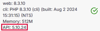

Restarted, emptied cache again, ran the update secret URL again, still says 2024-07-29. However, healthcheck is showing the correct “API” version:
which makes me think at least part of the update succeeded. Maybe this is a specific problem when going between 5.10.16 to 5.10.24?

A few users have been seeing issues with the force update button. That should only be showing up if a new version is available.

Most like in your public/ directory you have an old index.html which is overriding the index.
If you remove this, you should see the update.
@david I removed the index.html file, but now I just have the old Flutter UI. That doesn’t seem right…

In the flutter UI, what happens when you use the React Icon in the top right corner to switch to the react application?
@david that worked! The build date now shows v Latest Build - 2024-08-15.
